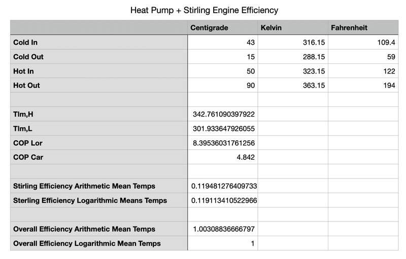

  • #61
russ_watters said:

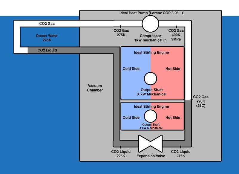

Ahh, ok, I've got it: the paper is talking about progressive cooling/heating of a source/sink. For example, if you want to heat your house from 10C to 20C if you first supply it 11C air, then 12C air, then 13C air, etc. you get higher efficiency than if you'd provided 20C air from the start. That's true, but that isn't what we are doing with your system. Your system is operating at steady state.
If that’s true, and you remove the part of the pipe that goes through the water (so the heat pump is a closed loop entirely enclosed in vacuum with no contact with the water), and the stirling outputs less than than the compressor mechanical input (when the system reaches steady operation), where is the energy going that’s not coming out of the stirling engine?
Science news on Phys.org
  • #62
The Stirling engine has two outputs:
1. Heat (rejecting too much)
2. Mechanical power (not enough)
The loss can be in either or both.
Or if it isn't absorbing enough heat in the input, the heat pump loop just gets hotter and hotter.

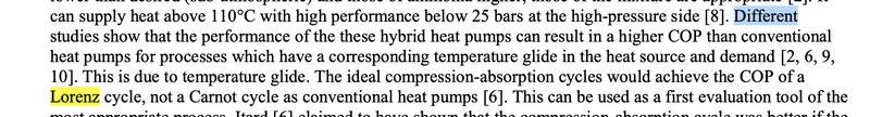

It says “based on the concept of Lorenz cycle”
The maximum overall COP, optimum subcooling degree and discharge pressure are closely related to the temperature glide of the mixtures.”
From my readings I had gathered that “temperature glide” means when the temperature in the C02 changes in the condenser. If the C02 was losing heat entirely during the gas to liquid transition (vapor % is changing), it’s temperature would remain constant, so temperature glide is when the temperature doesn’t remain constant across the condenser (ie releasing heat while CO2 is entirely liquid or gas).
From my reading I had gathered that the “lorenz COP” is the COP you get when the C02 does have temperature glide, and the “carnot cop” is the COP you get when the CO2 doesn’t have temperature glide.
For example with 400k to 275k on the hot side and 225k to 275k on the cold side, it’s more efficient to lift the temperature from 275k to 400k (lorenz cop) than it is to lift the temperature from 225k to 400k when there is no “temperature glide” (carnot cop).
From this paper:
https://backend.orbit.dtu.dk/ws/portalfiles/portal/149827036/Contribution_1380_final.pdf
If I use the same temperatures as circled in the table from the paper, I calculate the same lorenz cop and carnot cop as shown in the paper's table (see above and below)...
... but if the Cold in and Cold Out are both essentially the same temperature (15C - no temperature glide in the evaporator) and the hot in and hot out are the same temperature (90C - no temperature glide in the condenser), then the lorenz cop is the same as the carnot cop, and the carnot cop is the same carnot cop as shown in the paper's table (see below):

Almost. For the Lorenz cycle, there isn't just a temperature change in the condenser, there is more than one heat pump/condenser. To put the issue another way: ordinarily you want a constant temperature with a phase transition in each heat exchanger. Due to the poor characteristics of CO2 as a refrigerant, they are mixing in with it a more traditional refrigerant, which results in a varying temperature instead of a constant temperature. This is a bad thing, not a good thing. One way to mitigate this problem is to add additional heat pumps, moving energy at different delta-Ts. You don't have this.
No. The Lorenz COP comes from combining/using multiple refrigerant cycles. It helps reduce the downside of the temperature glide by having separate cycles for the different temperatures. The paper describes a system with two heat pumps working together.
None of this has anything to do with your cycle, though. Your system only has one heat pump. You're taking bits and pieces of papers about cycles that aren't the same as yours and mis-applying them. You really need to go back to the basic principles and analyze your cycle for what it is, according to those principles:

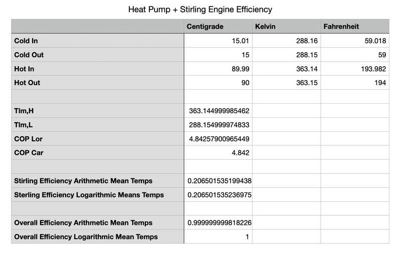

The lorenz cop is the same as the carnot cop when there is no temperature glide...
See below COP Lor and COP Car...
  • #70
Yes...

I really think you need to take a step back and define and evaluate the problem you are trying to solve for what it is. I think you are getting lost in the weeds.

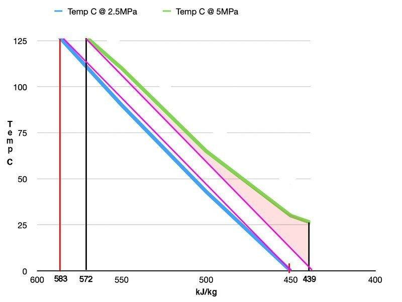

So if the CO2 stays a gas (never a liquid -- no phase change), and as it comes out of the expansion valve it's 15C, it heats (from the some water) to 43C, after compression, it's 90C, and as it transfers heat to another fluid, the CO2 gas cools to 50C (as shown in the table below), the COP of the heat pump is 8.39 (the lorenz cop). If it was a vapor/liquid mixture at constant 90C after the compressor and constant 15C after the expansion valve, the COP would be 4.84 (the carnot cop), and the lorenz cop would be the same as the carnot cop (see second table).
  • #72
No, that's not how this works. Lorenz COP does not apply here because you only have one cycle. Your compressor does not care about the poor performance of your working fluid, it only cares about its own inlet and outlet conditions. Please think about what your cycle is actually doing. If the temperature out of the compressor is 90C instead of some value between 50 and 90C does that mean you needed more or less input power at the compressor?
