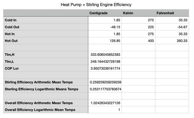

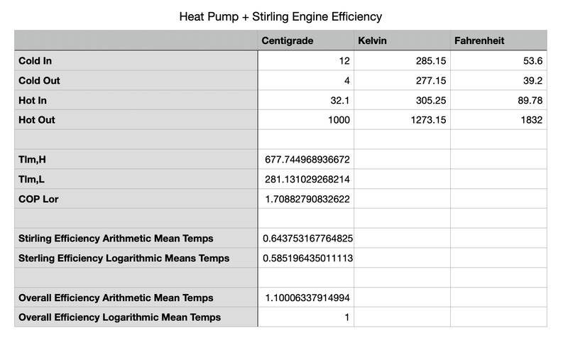

Well I had convinced myself I had found the error in my heat pump + stirling calculation.
First I calculated the Lorenz COP for a given set of heat pump temperatures. Then I used the logarithmic mean temperature of the hot side and cold side to calculate the stirling efficiency. When I multiplied the 2 together it always gives an answer of 1, in other words the stirling isn't generating any excess power.
For example cold in 12C, cold out 4C, hot in 32.1C, hot out 1000C, gives a Lorenz COP of 1.70... and using the logarithmic mean temps of each side, the stirling gets 58.5...% efficiency. Multiply the 2 together and the stirling isn't generating any extra power (1.70... x 0.585... = 1).
But if I use the arithmetic mean temps instead, which are higher than the logarithmic mean, then the stirling gets higher efficiency, and it pushes the combined efficiency over 100%... 1.70... x 0.643 = 1.10...
So my understanding was that in real heat pumps, there are 2 phases in the condenser, and I simply wondered whether the average temp of the condenser could ever be larger than the logarithmic mean.

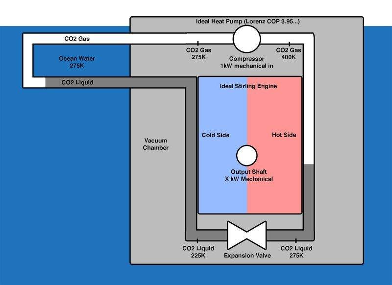

Suppose I choose CO2 as a heat pump coolant and in both the cold & hot sides of the heat pump, I want the coolant fluctuating between liquid and gas. The heat source is 275K ocean water.
If I use cold in 275K, cold out 225K, hot in 275K and hot out 400K, I calculate a Lorenz COP of 3.95... and if I use the logarithmic mean of the heat exchangers to calculate the stirling efficiency I get 0.25...
If I multiply those together the answer is exactly 1.

Suppose it's the hot side heat exchanger of the heat pump, the fluid circulating in the heat pump is CO2, at sufficient pressure where the peak temp of the hot side is 400K as a gas and the low temp is 275K as a liquid. Is the average temp higher than the logarithmic mean temp on account of the phase change? Latent heat in addition to sensible heat?
Can you please provide a schematic diagram of the system?
To calculate the Lorenz COP, I used equations 2,3 & 4 at:
https://backend.orbit.dtu.dk/ws/portalfiles/portal/149827036/Contribution_1380_final.pdf
To calculate the ideal stirling efficiency, I used equation 1 with the logarithmic mean temps of the hot and cold heat exchangers of the heat pump (but I have my doubts the logarithmic mean temp is actually the average temperature since there is a phase change in the heat exchangers).

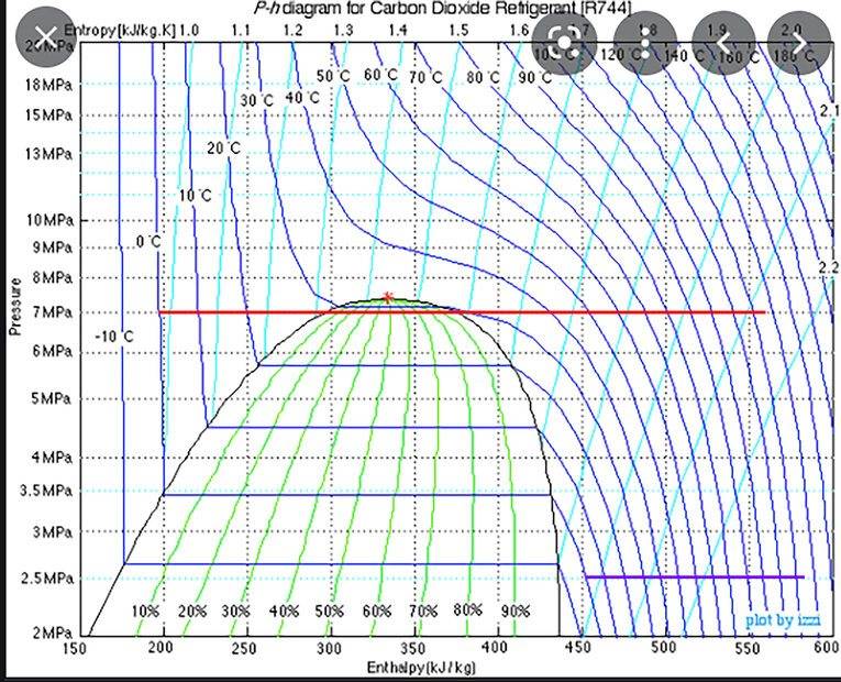

Carbon_dioxide_pressure-temperature_phase_diagram.svg

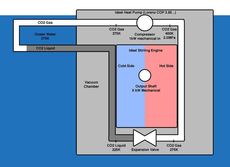

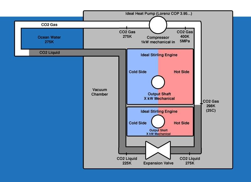

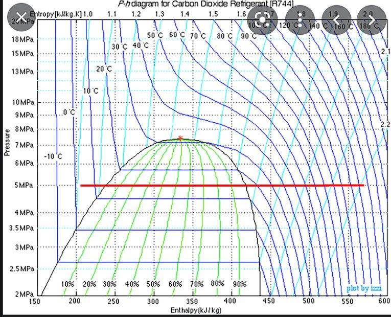

What is the CO2 pressure when its temperature goes from 400 K to 275 K?
I hadn’t considered it, but what if I choose 7.3MPa since it’s right below the critical pressure?
Maybe it’s above?
How about 5MPa?
Devin-M said:
How about 5MPa?
In any event, assuming (temporarily) that the CO2 pressure is approximately constant in the heat exchanger, we have $$\dot{m}\frac{dH}{dA}=-U(T-T_h)$$where ##\dot{m}## is the mass flow rate, H(T) is the enthalpy of the stream (even including liquid) at temperature T, A is the cumulative heat transfer area, U is the overall heat transfer coefficient, and Th is the temperature of the Stirling Engine working fluid (assumed constant) on the hot side. This can be integrated as $$\int_{H_{in}}^{H_{out}}{\frac{dH}{(T-T_h)}}=-\frac{UA}{\dot{m}}$$The only way this is going to lead to the LMTD is if ##dH/dT=C_p## is constant.
I have to admit I’m stepping a little past my area of knowledge here. Is it clear to you whether the hot side avg temp will be equal to, less than or greater than the logarithmic mean temp of the hot side?

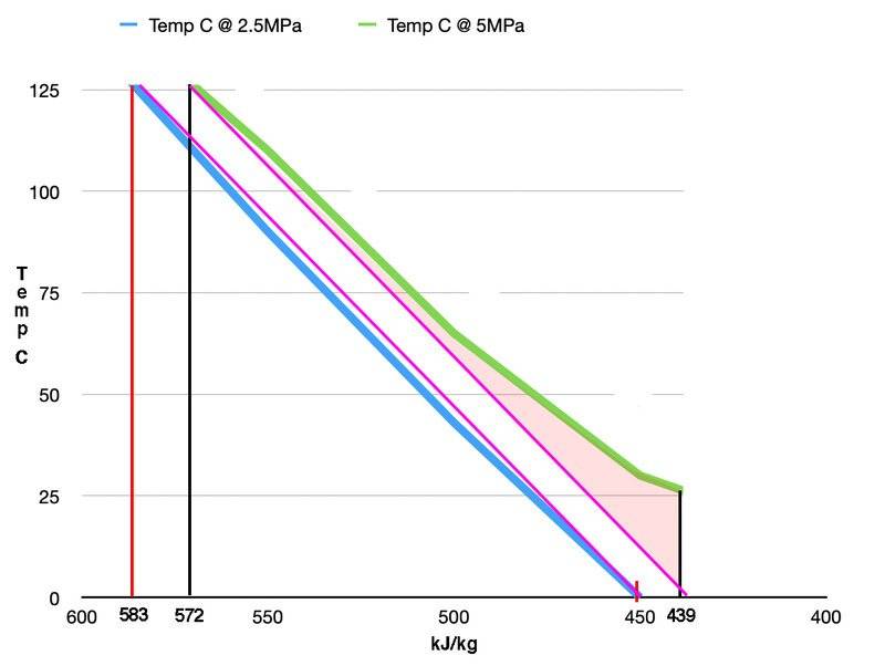

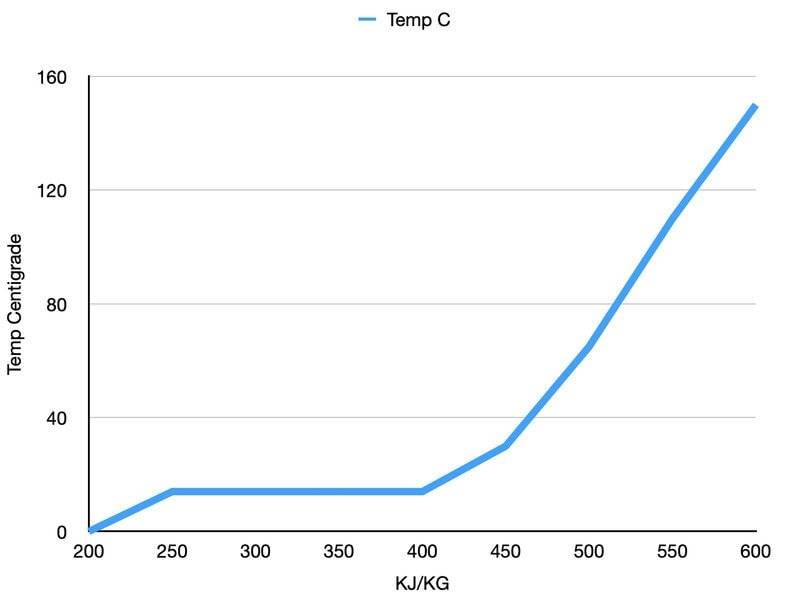

From the graph in post #10, at 5 MPa, make a graph of T as ordinate versus H as abscissa, running from 2 C to 127 C. Let's see what it looks like.
like this? edit: (fixed)...

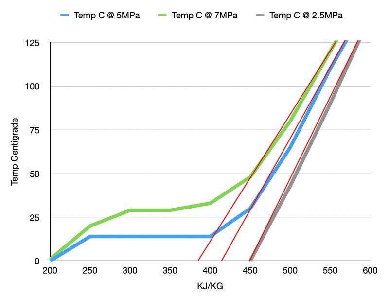

T as ordinate vs H as abscissa for the interval spanned by the red line.
Here I think I fixed it...
added in some more data for 7MPa in addition to 5MPa...

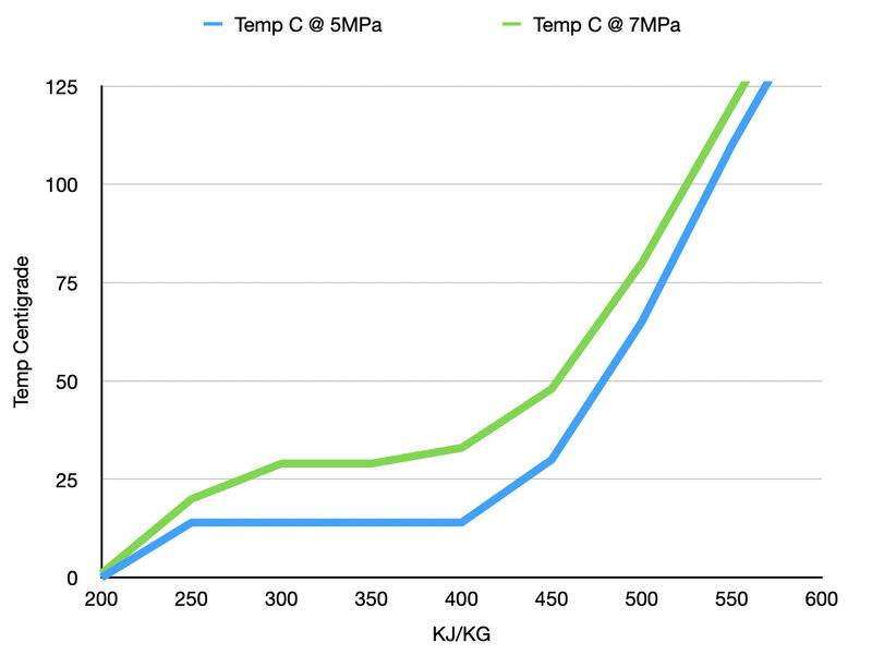

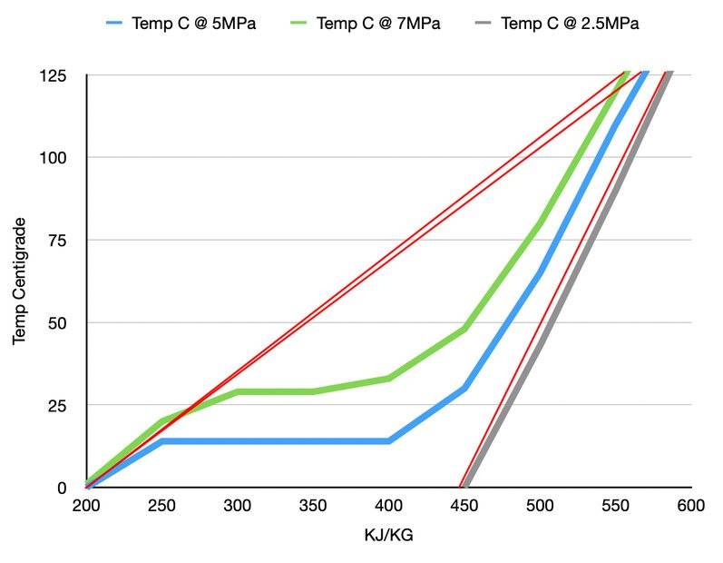

Excellent. The next step is to draw a straight line between the two end points of each of these variations. This is how the temperature would have to be varying with enthalpy if the LMTD were going to be the correct one to use. Let's see the comparison.
I added one more dataset @ 2.5MPa that doesn't phase change in the heat exchanger & stays as gas from 127C to 2C. Compared to the not phase changing 2.5MPa option, the 5MPa and 7MPa options seem to release much more energy per kg for the same temperature change. The 2.5MPa option releases about 120KJ/KG from ~127C to ~2C whereas the 5MPa and 7MPa options release about ~350KJ/KG for the same temperature change or about 2.9x as much energy released at 5MPa and 7MPa for the same temperature change.
Devin-M said:
I added one more dataset @ 2.5MPa that doesn't phase change in the heat exchanger & stays as gas from 127C to 2C. Compared to the not phase changing 2.5MPa option, the 5MPa and 7MPa options seem to release much more energy per kg for the same temperature change. The 2.5MPa option releases about 120KJ/KG from ~127C to ~2C whereas the 5MPa and 7MPa options release about ~350KJ/KG for the same temperature change or about 2.9x as much energy released at 5MPa and 7MPa for the same temperature change.View attachment 286311
Very nice. You can see that the average temperatures of the CO2 during the heat exchange at 5 and 7 MPa are much lower than implied by the average temperature variation for the straight lines (which would be the variations leading to a log mean temperature difference). Therefore, the correct "effective average" temperature difference to use in the equation ##\dot{m}(H_{out}-H_{in})=-UA\Delta T## is going to be less than the LMTD. If you want to quantify this to compare the correct effective average temperature difference with the LMTD, you can calculate the effective average temperature difference from $$\Delta T=\frac{(H_{out}-H_{in})}{\int_{H_{in}}^{H_{out}}{\frac{dH}{(T-T_h)}}}$$
In the case of the 2.5 MPa (where the CO2 stays a gas), the LMTD would come very close to matching the effective average temperature difference. So the LMTD would be OK for this case.

You can see that the average temperatures of the CO2 during the heat exchange at 5 and 7 MPa are much lower than implied by the average temperature variation for the straight lines (which would be the variations leading to a log mean temperature difference). Therefore, the correct "effective average" temperature difference to use in the equation m˙(Hout−Hin)=−UAΔT is going to be less than the LMTD.
I'm still confused by this part. Compared to the 2.5MPa case, in, for example, the 7MPa case, for the same amount of KJ/KG released from the C02, say when the enthalpy is down to 350KJ/KG, the temperature is higher in the 7MPA case than the 2.5MPA case. Wouldn't that mean the average temperature is higher than the logarithmic mean, not less?
Devin-M said:
This part makes sense to me.I'm still confused by this part. Compared to the 2.5MPa case, in, for example, the 7MPa case, for the same amount of KJ/KG released from the C02, say when the enthalpy is down to 350KJ/KG, the temperature is higher in the 7MPA case than the 2.5MPA case. Wouldn't that mean the average temperature is higher than the logarithmic mean, not less?
The temperature is lower during the condensation than if the condensation did not occur. Try integrating that equation I gave numerically to compare the effective average temperature difference with the LMTD.

We are not comparing the different pressure cases with one another. We are comparing each of them with the hypothetical temperature vs enthalpy relationship that would have to exist for the CO2 in order for the LMTD to apply. In all three cases, the hypothetical (leading to the LMTD) average temperature of the CO2 profile for heat transfer driving force would be about 60 C, and this would also be the effective average temperature of the CO2 for heat transfer in the 2.5 MPa case. The effective average temperature of the CO2 in the actual 7 MPa case and in the 5 MPa case would be substantially lower than 60 C. In the 7 MPa case, from the graph (by eyeball), I"m guessing an effective average temperature of about 50 C and, in the 5 MPa case, a value of about 40 C.
If I have 1 kg of CO2 at 127C at 2.5MPa, and it's -10C outside, and I let it cool to 0C at constant pressure (by convection to the environment), it has lost 140kJ.
If I have 1kg of CO2 at 127C at 7MPa, and it's -10C outside, and I let it naturally cool by convection so that the same 140kJ exits the 1kg at constant pressure, it's still 35C...
...that's 35C warmer than the 2.5MPa CO2 that has lost the same energy to the environment.
Wouldn't that mean the average temperature is higher with the 7MPa CO2 than the 2.5MPa CO2, because after releasing the same energy, the 7MPa C02 is warmer?
The comparison should made be for the same temperature change. In that case, for the 7MPa , a larger fraction of the heat is transferred at lower temperatures.
