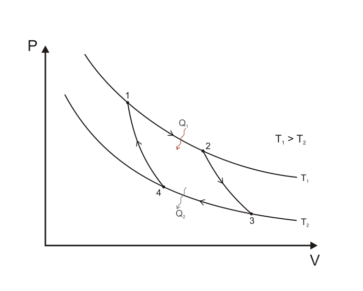

An ideal Carnot engine is composed of two reservoirs and a working fluid. The hot Reservoir and the cold one have temperatures ##T_1## and ##T_2## respectively, with ##T_1>T_2##. The working fluid is in a phase transition and has temperature ##T_1## at the start of the Carnot cycle. It undergoes another phase transition at ##T_2## at the end of the cycle to return to its original state.This is a P-V diagram of the Carnot cycle which proceeds in fours steps:
I'm particularly interested in the two stages (from 1 to 2) and (from 3 to 4). They can be described as follows:
1) Stage (from 1 to 2) is an reversible isothermal expansion of the working fluid to transform from the liquid state to the gaseous one. The working fluid is at ##T_1## and it happens to have boiling point at ##T_1##; Hence heat ##Q_1## is supplied to the fluid from the hot reservoir until it transforms to a gas keeping its temperature constant along the whole process.(that the fluid's temperature is constant during the whole process is owing to it being in a phase transition).
2) Stage (from 3 to 4) is an reversible isothermal compression, and its similar to what we have just described, with the difference being in this case, heat ##Q_2## is drawn out of the fluid and transfers to the cold reservoir and the fluid transforms from gas to liquid retaining a constant temperature of ##T_2## throughout the whole process
I'm puzzled by the mechanism by which the working fluid undergoes phase transition. So at stage (from 1 to 2), both the fluid and the hot reservoir have the exact temperature, so that they're in a thermal equilibrium; Hence there should be no heat or energy exchange between the two bodies. The same can be said of stage (from 3 to 4).
So how is it possible for heat to flow from two bodies having the exact same temperature?

Since you are correct that heat transfer cannot occur if there is no temperature difference, clearly there must be a temperature difference. What you are seeing in the diagram and description of the cycle is the temperature of the working fluid only. It tells you very little about the temperatures of the hot and cold reservoirs (only that they must be hotter and colder, respectively, than the evaporation and condensation stages, respectively).

Yeah, you're right. The Carnot cycle presents an ideal/limiting case for efficiency. The larger you make your heat exchangers, the closer you can get to having the temperatures the same, but you'll never quite get there. That would be part of the reason the ideal case is not achievable.
In step 1-2, the reservoir temperature is slightly higher than the working fluid temperature and in step 3-4, the reservoir temperature is slightly lower than the working fluid temperature.

Your PV diagrams for the isothermal processes are wrong. What you drew are the PV diagrams for an ideal gas. For a gas undergoing a phase transition from liquid to gas, the ideal gas law does not hold, and the shape of the isotherm is completely different. In fact, for the process you are interested in, the temperature AND the pressure are constant. There is a change only in volume as the liquid expands and becomes a gas. The heat absorbed by the system is the heat of vaporization. Similar statement is true for the process at T2.

If I remember correctly the reservoirs are considered "ideal" - zero thermal resistance between the reservoirs and the fluid - so that you don't need much temperature difference (approaching zero) to cause infinite power to flow from the reservoir to the fluid. So effectively you can assume the reservoir and fluid are at the same temperature.
