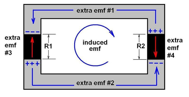

Hikaru, thank you for being the only respondant to have the courage to post and answer to my question.

stevenb said:
I hope that is not the point of his confusion because it's clear that the scopes are effectively tied to the same point, and such a small inductance is irrelevant on these time scales. You can take the same voltmeter or scope, pick it up, move it to the other side and the reading will change. You could swap the meters and their reading would also swap.
@ stevenb: look at the video part 2 at around 5:23. Freeze the video and look at his setup. The probes are NOT "effectively" connected to the same point. There is about 4-6" of wire on the secondary loop with the resistors on it. That means inductance to me. Your claim of moving the scope to the other side befuddles me, because the ENTIRE point of prof. Lewins lecture is not about the how to measure this system, but that across each resistor, a different voltage occurs, which I agree with.
Think of it this way: If 1mA amp is induced in the system, OF COURSE (as he puts it) there will be a -0.1V drop on the 100 Ω res, and 0.9V drop on the 900 Ω res. Now, if we simplify the system by saying "node A" is actually "effectively" the same point, we know have 1 V drop across "node D", a supposedly 0 Ω line (by Lewin's model). That means Lewin also denies that Ohm's Law applies in this situation, because that would mean infinite energy.
Ohm's law is hard to dispute, because this is more of a definition than a theory. Therefore, I contend we have a breakdown of his model.
Conversely, since you (stevenb) seem to be very sure of your answer (I am not 100% sure of mine, that's why I asked the question, and would like to learn), can you tell me how the energy got into the system from the main coil to his resistor circuit? Does it not involve inductance? I don't know of any case where you can couple energy like this without some kind of coupled inductor setup.

The professor goes through a process of setting up the problem. First he describes the case with a 1 V battery in the loop, and then he erases the battery cell and uses changing flux in the center of the loop to replace the 1 V EMF. How can you say "he just miss the voltage source of the transformer"? He didn't miss it at all.
Faraday's Law in integral form just tells you that the 1V EMF exists somewhere in the loop. It doesn't specify where it is in the loop. Typically, a transformer is tapped to change the number of loops is the circuit, not to somehow tap a section of one loop. The details of what happens when tapping one loop need to be considered more carefully, as has been done in the provided analysis. In this case we know where the potential drops are (we can measure them with a meter that does not encircle the flux change) and we see that it adds up to 1V around the main loop. There is very little potential drop across the wires themselves. The transformer EMF in the main loop is 1V, so all is well with Faraday's Law. Also, all is well with the classical definition of KVL (given by Maxwell). Obviously, the version KVL that says the sum of potential drops is zero is violated, which makes the professor jump up and down and denounce his physics books for spouting bad physics.
In doing the proper measurement for potential on each resistor, you trace a path (through the meter and the resistor) that does not encircle the flux change and this tells you which resistor potential you are actually measuring. FL and KVL (both versions of KVL, mind you) work here. The Professor also reveals that if you consider the path through the other resistor, you see an apparent contradiction. You end up tracing a loop through the other resistor that encircles the flux change and you are not really measuring the potential on that resistor. Faraday's Law still works through that other path, and the classical definition of KVL also works, but the other definition of KVL fails yet again.
Since the professor is not actually acknowledging the classical definition of KVL, we can just ignore that aspect, and conclude that everything he is saying is correct. The results do not depend (other than small parasitic changes) on where you tap the node along the wire, but they do depend on how you route the leads of the meter. If we had the experiment in front of us, there would be a very simple way to prove this. Simply move the exact point where you tie into the nodes and see if the measurements change. It is my contention that they will not change very significantly. Anyone who doubts this should just do the experiment and convince themselves. Do you really think the people who set up this experiment would go through all this trouble, and then not verify this straightforward thing? You really think MIT people can miss a factor of ten in this way? That's hardly proof, but experiments are proof. I've done similar experiments in the past as part of my work. I can't ask anyone to accept my word, and if others don't want to accept the professor's capability, then just do the experiment.

I think we are talking in circles. Just look at the circuits as the secondary of the transformer with two resistors connect in series between the two end of the secondary. Then adjust the voltage at the primary to get EXACTLY 1V across the two resistor, you get what the professor was doing. Nothing more. YOu measure the 100ohm, you get 0.1V and 900ohm you get 0.9V. Problem is you miss the whole secondary of the transformer that generate the 1V to drive the 1V across the resistor.
Do you understand that if you connect the two resistors like what the professor draw, you form a loop EXACTLY like the secondary of the transformer with two resistors in series connected at the two end of the secondary? The length of the wire is not an issue here, it is the loop that create the transformer...that create a voltage when a varying magnetic field pass through the area enclosed by the loop. The professor has to draw in the voltage generator in his two resistor loop, with that, KVL hold.
You work with transformer before? You ever seen voltage created in just one or even half a loop of wire? If you don't believe me, just wind a 10 turn on a bobbin of some non magnetic material, then wind one turn on top as a secondary. You can even put the same two resistor in series. Hook up a scope onto the two end of the secondary. Use a 1.5 volt battery on the primary with a switch. Open and close the switch and see the meter needle jump, see how high ( voltage) it just! You will see that one little loop with only 1" or less can produce voltage.

Claude, I am glad you use your example and we can build on this. If you remember the professor original drawing of replacing the 1V battery with a short circuit and then sent a magnetic field to get 0.1V on the 100ohm and 0.9V on the 900ohm.
Use your example. We use 110ohm in series with 9ohm across the secondary. Then we pulse the primary to get 9V on the 9ohm and 110V on the 110ohm. As in the professor case, let A be the junction between two resistors which in this case has 0 length. Where is point D?
He obvious know that the setup he had, by replacing the 1V battery with a short wire result in a loop formed by the wire and the resistors. Then he said he measure 0.1V across 100ohm and 0.9V across 900 ohm. Then he claimed he measure say clockwise from one point is 0.1V and counter clockwise as 0.9ohm! So where is the transformer that gave him the induced voltage in the picture?
Back to your example, the wire is the secondary of your transformer, point D is not a point, it consist of the winding (wire) of your secondary winding.
Is there any way for me to post a simple drawing of just two resistors and the secondary of the transformer without have to using a PDF and then attach, then have to wait for a day for other people to see it? Let me try this.
Let us redo the presentation again:
1) Let's arrange the components in counter clockwise.
2) Start with the 900ohm, then 100ohm and call the point between the two resistor is point A. I call the open end of the 900ohm resistor point C.
3) Then we connect one end of 4" wire to the 100ohm resistor and call this junction B. Remember I am still going counter clockwise now.
4) Then the other side of the 4" wire connect back to the open end of the 900ohm resistor which I call point C in step 2.
With this, we form a closed loop starting from point A between the two resistor, travel counter clockwise through 100 ohm resistor, to point B to the wire, through the wire to point C that connect to the other side of the 900ohm resistor.
Then you inject a pulse of magnetic field, you measure 0.1V across the 100 ohm resistor, and 0.9V across the resistor. Just like the good professor did.
Lets call point C is +ve and call point B as -ve. Let's travel from point B counter clockwise through point C to point A, you get 1V-0.9V=0.1V. If you travel from point B clockwise this time to point A, you get 0.1V! Why are they the same now? Because the transformer effect, this time I include the transformer in the picture and voltage come together! IN this case, KVL works beautifully.
