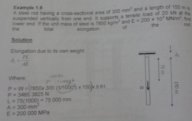

for the elongation due to its own weight , i suspect the calculation of elonation due to its own weight is wrong ...
I think it should be (3456.3825)(75) / (300x10^-6)(200x10^3) = 4320m = 4320x10^3 mm , right ? [/B]
Four kilometers?!
Bystander said:
Four kilometers?!
anything wrong with my calculation ?
Given that the original length is only 150 meters? What's your conclusion?

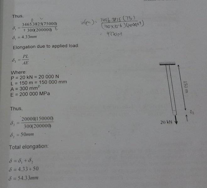

sorry , here's the second image
You've made mistake(s) in the conversion to meters (handwritten work, 2nd image). Try it again.
I'm looking at the units of E in his calculation, and it doesn't seem correct to me.
