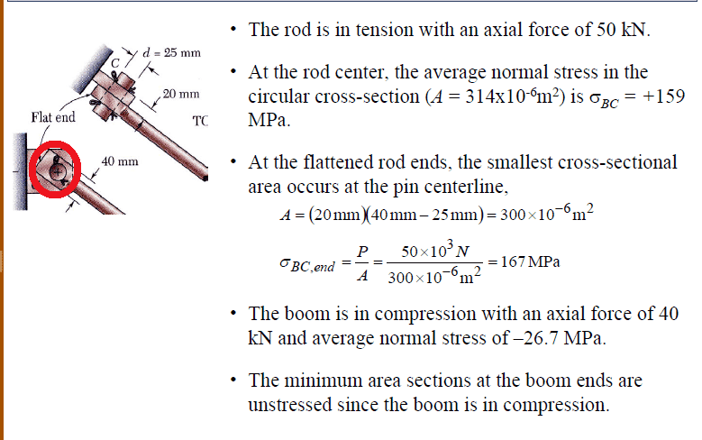

For σBC end , i don't understand how the author get (20mm)(40mm-25mm) = 300x10^-6 (m^2) ...
IMO, , the area should be the circled part (thin rectangular part of the rod) , but i only know one dimension only , which is 40mm , i don't know the another one , how to proceed ?
40mm - 25mm is the material either side of the hole.
The rod end is 40 wide, less 25 mm for the material missing due to the hole.
This is then multiplied by the rod thickness.
This is the area of the two rectangles we would see if we cut the rod parallel to the end face and coincident with the pin centre line.

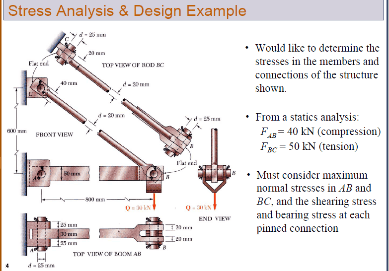

The thickness (and pin diameter) is shown on the plan view just above your circled diagram.
It's just a rectangular prism with a round hole in it, try draw your own diagram, post it if you get stuck.

Can you see how the two diagrams show two views of the same assembly?
Sketch a rectangular prism with a round hole (the rod end) include all the dimensions given, post the drawing.
I assume you're studying mechanical engineering? You haven't done any technical drawing or CAD yet? You'll be expected to interpret drawings of much more complex parts and assemblies and also produce your own drawings, if you're having trouble with this simple part I'd recommend that you start practicing now so you're prepared.

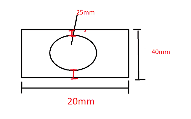

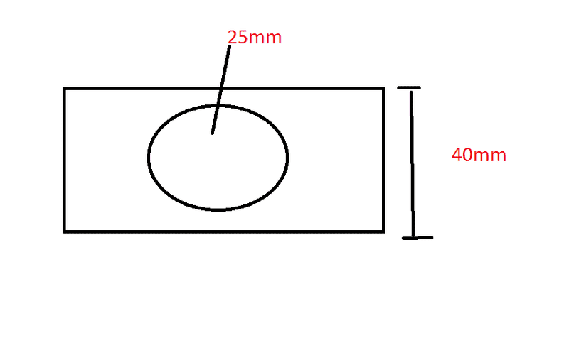

like this ? I am not sure though .
Yes, that's right. If you project backwards you can show the thickness too.
How much material is left either side of the hole to support any loading?
Can you see the significance of 40mm - 25mm now?

the total of 2 red part i add now represent 40 - 25 mm , but where is the 20mm? i didnt see it
The 20mm dimension is next to the 25mm dimension.
It's given for the fixed support but it's fair to assume they're both the same thickness.

the diagram is confusing ... From the top view , i found that the rod is quite thick (green line represent the thickness) , However , when we view it from front , it is a flat tod ( very thin) . Or you can draw me a 3d diagram please?
t

do you mean here ( in the photo attached) represent 20mm ? if so , it doesn't make sense , right? Since the diameter of circle already = 25mm , which is > 20mm

You're looking for the area of the two cross hatched sections:
Gy_Jw5qCEOf8Ti1UfmUGkKcJfmSH4xOauYBuYh0TYXbFlum00Ul6lvKJhweo6r-qFwJD7yn_7Hi4i8Wvtzp=w580-h676-no.png
Note that we've taken the authors word that this is the smallest cross sectional area of the rod.
[EDIT: Actually, they do show it's the case]
It is, but only by a very small margin, if the hole size was reduced to 24mm it wouldn't be the area we need to consider.
In future, you'll need to prove that you're using the correct cross section.

Come on, It's shown two times on your first attachment! it's even labeled with a 'd' so you know its a diameter of a circular section!
Interpreting the diagrams in this question should only take a few seconds, if you want to pass your exams you'll need to seriously improve your skill in this area.
