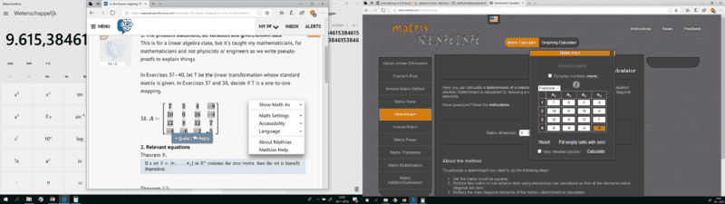

This is for a linear algebra class, but it's taught my mathematicians, for mathematicians and not physicists or engineers so we write pseudo-proofs to explain things.
In Exercises 37–40, let T be the linear transformation whose standard matrix is given. In Exercises 37 and 38, decide if T is a one-to-one mapping.
38. ##A = \begin{bmatrix}
7&5&4&-9\\
10&6&16&-4\\
12&8&12&7\\
-8&-6&-2&5\\
\end{bmatrix}##

I personally don't believe that the mapping (judging by the RREF matrix) is one-to-one.
Why don't you try testing Theorem 12 (b)? Can you tell me what the definition of linear independence is?

Yeah I see now that ##\bar{a_3}## is a linear combination of ##\bar{a_1}## and ##\bar{a_2}##, so ##\bar{0} \in S_A##.
As a follow up, I like to think in terms of row vectors. Would it be acceptable for me to take the transpose of a matrix and row reduce it to show that there is a zero vector solution?

  • Screenshot of a Math-Mathias-style forum page showing a 4x4 integer matrix in Exercise 38, with a context menu open, beside a Matrix Calculator page for computing the determinant of a 4x4 matrix.
