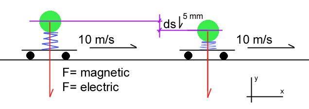

milesyoung said:
No one is arguing that a magnetic field can't change the trajectory of a point charge in motion. It just can't change its SPEED, i.e. it can't change its kinetic energy because the magnetic force on it can't do any work.
Work is force times displacement, speed is not a part of the equation. Anyway, do you think a free electron would not change its speed when passing next to a permanent magnet where this external B field maximum gradient density is not located perpendicularly to is trajectory, but this time more in front or behind it?

  • #40
Regardless of source and gradient, the magnetic force won't change the speed of the particle.
Here I use only the definition of work and the expression for the magnetic force:
[tex] W = \int_{t_1}^{t_2} \mathbf{F_\mathbf{mag}} \cdot \mathbf{v} \, \mathrm{d}t = \int_{t_1}^{t_2} \left( q \mathbf{v} \times \mathbf{B} \right) \cdot \mathbf{v} \, \mathrm{d}t = \int_{t_1}^{t_2} 0 \, \mathrm{d}t = 0[/tex]
It's a very simple equation. You're saying this is somehow wrong?

WannabeNewton said:
You seem to have a very dramatic misunderstanding of the basics of forces. Constraint forces do not do work. This is because constraint forces always act orthogonal to the instantaneous displacement. The magnetic part of the Lorentz force is a constraint. It is given by ##\vec{F} = q \frac{d\vec{x}}{dt}\times \vec{B}## so clearly ##\vec{F} \cdot d\vec{x} = 0##. If this is not obvious to you then you should take a step back and review basic vector algebra.
What is significance of F.dx = 0? Dx is not the displacement vector we are interested in. Only displacement in the direction of the force matters.
There is no need to confuse yourself by considering magnetism. Does the tension in a string due to an attached mass moving uniformly in a circle do work? Does the normal force on a wheel rolling without slipping down an incline do work? Clearly not as these forces act orthogonal to the direction of motion. Their goal is to keep the particle(s) constrained to move along a certain trajectory hence the name constraint forces; in the case of the wheel the normal force keeps the wheel on the incline and in the case of the string the tension keeps the mass moving in a circle.
I don't know. What equation are you referring to and why would it have precedence over W= F*s?

  • #45
That is exactly what F.dx means, the force in the direction of the displacement! Wow! You really need to go back and learn basic vectors and Newtonian mechanics before you try to tackle fields and EM.

A toy car is moving in x direction with uniform velocity, it carries electrically charged ping-pong ball on a spring. Under the table we can turn on uniform magnetic or electric field separately. What is the difference between electric and magnetic force pulling down the ball in y direction? How can electric force do work when only magnetic field is turned on under the table?

I have not worked this problem or an equivalent problem in detail, so I cannot say for sure. If I had to guess then I would suspect that the energy would actually come from the KE of the ball, not the EM field at all.
However, if there is any work done by the fields then there must be E.J, per Poyntings theorem. The ball itself provides both E and J, so that is where I would look if the KE is insufficient.
  • #60
