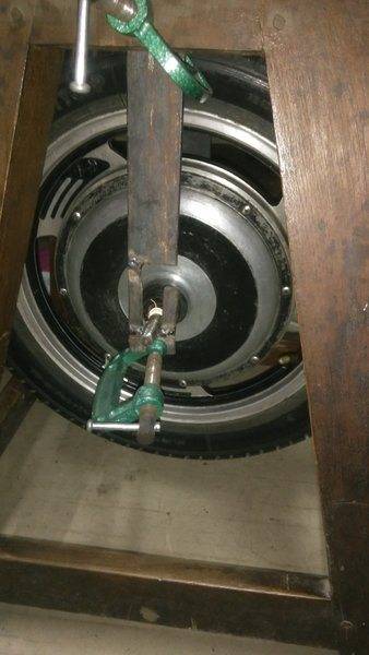

  • #45
I am very sorry. I made a mistake in Post #46. It appears that the averaged voltage was 0.554V while the averaged current was 5.77A. (The reverse seems to make more sense though.) As a result, since R = V/I, R = 0.553V/5.834A = 0.09 Ohms which is close to my measured 0.1 Ohms and the 0.123 Ohms given by the company. What do you think? How come the voltage across the motor dropped by about 10 times to 0.554V? The increased current seems to make sense as more torque (stall the motor) requires more current in an attempt to spin the motor.
  • #46
Possibly your 4V power supply has a high internal impedance.
Note also, the effective armature resistance varies depending on the operating point of the motor. This is the net resistance value you want to plug into your performance calculations.

Thanks David. I did one more set of tests. 10 runs at 5 volt from the power supply. The averaged measured voltage was 0.638V while the averaged measured current was 7.35A. The calculated resistance became 0.638/7.35 = 0.0868 Ohms.
When I tried input voltage at 6 Volt from the power supply, I smelled smoke and stopped immediately.
Which net resistance value do you mean?

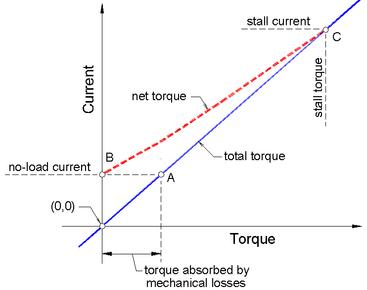

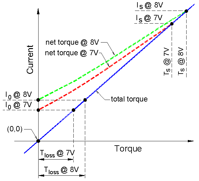

  • #56
bbq_build said:
The torque constant Kt is torque/current. Is this Kt the same regardless of the supply voltage?
Yes, within reason. The steel armature core can only conduct so much flux. When it nears saturation, the B/H curve flattens out.
Secondly, this is the grand total torque produced by the motor. Net torque at the shaft available to do useful work is less,
and that will make effective Kt less.

bbq_build said:
How about the torque vs. current line? The more the torque, the more the current. Am I right that when the voltage increases, this line also shifts upward?
When voltage increases, the current vs. total torque curve does not change. However, the current vs. net usable torque graph does shift upward, and Kt decreases as applied voltage increases.
The solid blue line represents current as a function of total torque. Point A shows torque absorbed by bearing friction, commutator friction, and windage. Moving a copy of Point A horizontally to Point B gives a plot of current as a function of net usable torque.
At Point C, the motor is stalled, so mechanical losses are zero. Net torque and total torque are the same. The dashed red line from B to C is not quite straight because windage is roughly proportional to the square of speed.

  • #59
Thanks David for the graphs.
I connected a small motor hub to the gearhead of the motor. Then, I measured the voltage, current and speed of turning (in RPM) using a tachometer. I found that the measured voltage is a bit less than the supplied voltage. This is probably due to the Back EMF. I am not sure if the added weight/inertia due to the hub could be neglected in the calculations. Here is the data:
Supplied voltage: 11.1V
Measured voltage across the motor: 10.2V
Measured current in serial with the motor: 1.2A
Speed (with the gearhead and hub): 78RPM (8.17 rad/s).
What can we do with the measured data? Any advice appreciated. Thanks.
  • #60
I am not clear on what you mean by a small motor hub.
I have derived a formula for current draw based on the torque absorbed by the load.
The equation of a straight line follows the form: y = mx + b (where m is the slope, and b is the y-intercept).
Referring to the graph in post #58:
I = [T(Is - Io)/Ts] + Io
I = motor current
T = load torque
Is = stall current
Io = no-load current
Ts = stall torque
Note that some of these variables depend on motor voltage (refer to the second graph in post #58).
