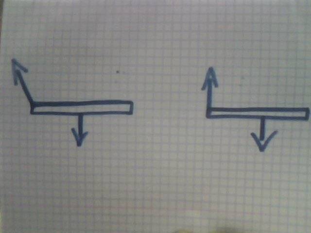

Getting back to the original diagram
http://img860.imageshack.us/img860/6118/40893341.jpg [/QUOTE]
In the YZ view. I think the left drawing is the correct one. Correct?
Good morning Fp! :smile:
Left! :wink:

Suppose you snip the cord CD, what would happen with the construction? Would it still be in equilibrium or not?
Left! :wink:
There is a little more to it, but some things are best experienced rather than be told.
(The others in this thread seem to agree, because I'm sure they know what's going on.)
However, since I love you so much and you are apparently very reluctant to do the work, I'll give you a hint. ;)
Of course not, it would be pulled over by TAB
And I'm not "very reluctant to do the work"! And I learn tons of things the hard way, and I like it. Sometimes I try it the easy way because sometimes the easy way works too and enlightens me too. :smile:
And I'm actually trying to solve it right now, after solving 7 questions on my own yesterday (statics+dynamics including 3D) from a test that was last year. So am always practicing to keep myself in shipshape :biggrin:
Much of course thanks to you!
Anyway, off with the verbosity and on to physics :smile:
Yes, to repeat, it would be pulled over by TAB :wink:
