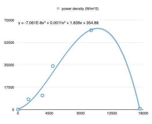

Wind energy density above Om's house (45°N 124°W)
100 m: 0
1500 m: 8 kW/m2
3500 m: 11 kW/m2 (our highest local mountain peak)
5000 m: 34 kW/m2
10 km: 62 kW/m2
18 km: 0.7 kW/m2
27 km: 0

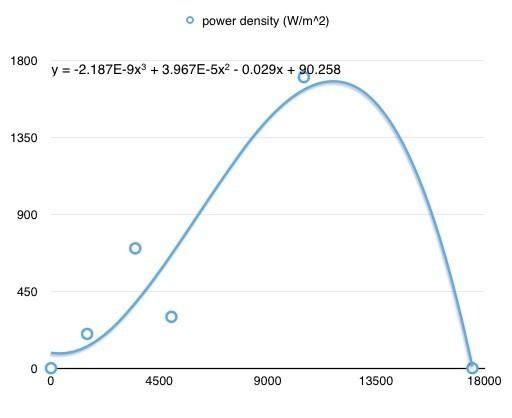

I was somewhat fascinated by the winds at 10 km along our local coast, so I did some calculations:
250 hPa (10 km)
Code:
coordinates         wind speed  power density
50.14°N 124.36°W    266 km/h    78.8 kW/m^2 (northern edge)
45.78°N 124.00°W    260 km/h    72.8 kW/m^2 (southern edge)
distance between 50°N 124°W & 45°N 124°W = 440 km
output at 20% extractable from just 1 meter: 6.6 gigawatts
Grand Coulee Dam nameplate: 6.8 gigawatts
Grand Coulee is America's most productive hydroelectric dam.
Though, a 10km tall, 440 km long scaffolding, strikes me as a bit of an economic/engineering problem. Not to mention, the wind is constantly shifting.

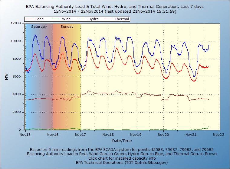

From a totally different perspective: One of the problems in power generation/distribution is control - determine where power is required and generate it to meet increasing or decreasing demand.
Wind is really variable, so in one area too much wind may require wind turbine shutdown and 20 miles away it may be nearly dead calm. What this means is that keeping the power grid in a known state solely with wind generated power is very difficult. It also may entail huge cost with today's implementation. Based on this model, the likelihood of getting to very high percentages of all power being wind generated in our lifetimes is small, without some gigantic strides in energy storage and transmission technology.
Current example of good implementation: Samso Island http://en.wikipedia.org/wiki/Wind_power_in_Denmark#Sams.C3.B8_Island
