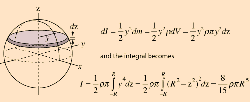

I also just had a small related question. I was just wondering why in this image, the derivation for I begins with stating ## dI = \frac{1}{2} y^2dm ##. Where exactly does this 1/2 coefficient come from? Shouldn't it just be ## dI = y^2dm ##?
Here, ## dI = \frac{1}{2} y^2dm ## is the rotational inertia of a thin disk of radius ##y## and mass ##dm##, as shown in the figure. So, the 1/2 factor is correct here. If ##dm## were the mass of a particle (rather than a disk), then ## dI ## would equal ##r^2dm ##, where ##r## is the distance from the point mass to the axis of rotation.
