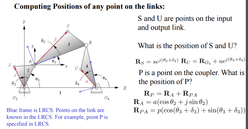

since they are in complex vector form, its missing a " j " on the sin() part, correct?

I believe you have it correct. It looks like a typo to me.
