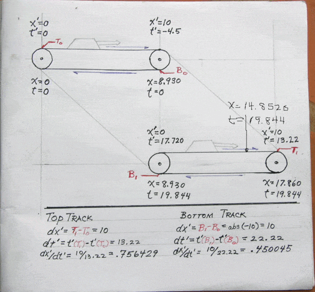

  • #67
calebhoilday said:
I would like to understand velocity addition and subtraction in special relativity, more than I currently do. It would be greatly appreciated if one could comment on the outcome of the following thought experiment.
Imagine ‘the super-tank’ a tank capable of speeds of 0.45 C is being designed. Someone on the design team, raises a potential problem. When considering the tanks tracks, the tracks that are in-contact with the ground or the bottom-side tracks, have no velocity until the tank moves over them and pulls them to the top-side. The velocity they have according to a stationary observer is twice the speed of the tank.
The member of the design team states that if you treat the tank as the stationary observer, then what ever speed the top-side has the bottom-side needs to have, just in the opposite direction. If this is not the case then the tank tracks would rip apart, as either the top-side or bottom-side tracks would not feed enough track to the other.
It is then shown that the tank will not have the same but opposing velocity for its tracks, in the reference frame of the tank, based on the velocity of the bottom-side tank relative to the ground observer being 0 and the top-side 0.9C.
U = (S-V) / (1-(SV/C^2))
U: The velocity of the tracks according to the tanks frame of reference.
S: The velocity of the tracks according to the ground frame of reference.
V: The velocity of the tank according to the ground frame of reference.
C: the speed of light in a vacuum.
Bottom-side velocity according to the tank
U = (0 - 0.45C) / (1-(0C*0.45C/C^2))
= -0.45C / 1
= -0.45C
Top-side velocity according to the tank
U = (0.9 - 0.45C) / (1-(0.9*0.45/C^2))
= 0.45C / (1-0.405)
= 0.45C / 0.595
= 0.7563C
How can this difference exist considering the concerns of the designer?
The tank body advances at [itex]v=0.45c[/itex] wrt the ground.
Since the tank rolls over the bottom track without slipping, then, in the tank frame
-the bottom of the track moves at [itex]v_b=-0.45c[/itex]
-since the track doesn't stretch, the top of the track moves at [itex]v_t=+0.45c[/itex]
In the gound frame the speeds are different:
[tex]v'_t=\frac{v_t+v}{1+vv_t/c^2}=.748c[/tex]
(not 0.9c as you keep claiming)
[tex]v'_b=\frac{v_b+v}{1+vv_b/c^2}=0[/tex]
[tex]v_{tank}=v=0.45c[/tex]
This is a simple problem, it does not merit so many posts.

  • #73
I can only refer to the 1st postulate, the physics is the same in all inertial frames.
If the tank works on Earth at slow speed, then moving it at some high speed shouldn't change the way it works, and definitely moving past it at some high speed cannot alter the way it works.
  • #74
Here is the problem analysed in terms of length contraction.
Let us say we have a simple tank with axle to axle proper length of 1.0 and a proper track length (considering only the horizontal portions of the track) of 2.0 when the tank engine is off.
In the tank frame (when the engine is on), the lower and upper parts of the track both have relative velocities of magnitude 0.45c so the half length of the track is 0.89302855 in the tank frame due to length contraction. One of the axles would have to have a tension control device to allow one of the axles to move inwards to prevent the track snapping under increased tension and so the axle to axle length in the tank frame would also have to be 0.89302855.
In the ground frame, the tank is moving at 0.45c and the axle to axle length is length contracted to 0.89302855*sqrt(1-0.45^2)= 0.7975.
The part of the track in contact with ground is stationary with respect to the ground frame so that part of the track has proper length 0.7975. The top part of the track also measures 0.7975 in the ground frame but because the top part of the track has relative velocity 0.7484407c in the ground frame (according to relativity), the proper length of the top part of the track is 0.7975/sqrt(1-0.7484407^2) = 1.2025. The total proper length of the track is therefore 0.7975+1.2025=2.0 in the ground frame.
Therefore a top track velocity of 0.7484407 is consistent with the relativistic addition laws and with relativistic length contraction if the total proper length of the track remains the same (2.0) in all frames. All this is totally consistent with relativity.
If the velocity of the top track was 0.9c, the total proper length of the track would not be 2.0 in both frames.
Therefore the velocity of the top track can not be 0.9c, if length contraction is a real physical effect and if proper length is invariant.
  • #75
Fredrik said:
Let's assume that this is correct, just to see where it takes us. What you said implies that the bottom track is comoving with the ground. In the ground frame, the tank's velocity is v=0.45 (in units such that c=1). By symmetry (the principle of relativity), or by definition of the inertial frame we associate with the motion of an object, this implies that the velocity of the ground in the tank's frame is -v. So...relative to the tank, the bottom track has velocity -v=-0.45, and relative to the bottom track, the top track has velocity u=0.9 (according to your assumptions). Now the velocity addition formula tells us that the velocity of the top track relative to the tank is (-v+u)/(1+(-v)u))=(-0.45+0.9)/(1-0.45*0.9)=0.45/0.595≈0.756, while the velocity of the bottom track relative to the tank is -0.45. This contradicts your other claim:
So your assumptions can't all be correct.
Right, because I was too intent on making the drivers pov symmetrical. After making a rough space-time drawing, I see my mistake.
I have to apologize to Caleb, his original equation was correct. [(0-.45)/(1-0*.45) = -.45]

This http://go.sharehub.com/shared/c6e7efb8-d0f3-4298-98bb-93038fb72b9b" shows why only .90c works.
  • #79
Huh. I thought what you said in #75 meant that you now understand that it isn't possible that the topside speed is 0.9. Does this mean that you still think it is?
I don't understand your drawing by the way. You should probably explain it if you want DrGreg to explain what's wrong with it. (I think I'm going to abandon this thread now. The correct answers have been given several times already).
