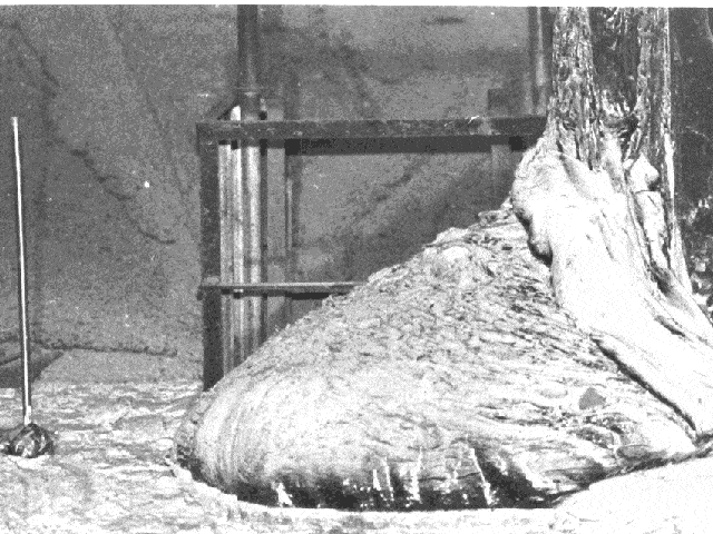

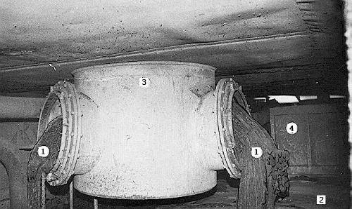

Astronuc said:
The debris hanging from the base of the hole in Unit 4's secondary containment looks like insulation.
I'm happy to be proven wrong on this and I can only say the tongue looks like corium lava.
[PLAIN]http://www.cernobilturkiye.com/content_images/1/ch/chernobyl.jpg
[URL]http://files.abovetopsecret.com/images/member/bf822b7d3b8e.gif[/URL]
[PLAIN]http://upload.wikimedia.org/wikipedia/en/6/65/Pictureofchernobyllavaflow.jpg
See:
http://en.wikipedia.org/wiki/Corium_%28nuclear_reactor%29"
Astronuc said:
The hole appears to be above the floor of the concrete structure of the reactor building.
I disagree completely. Fukushima 1 units 2, 3 & 4 all have a clear ridge around the external building that denotes the boundary between the floor level - the level of the reactor "mouth" and the top of the spent fuel pool - and the concrete containment and other concrete support. The hole is clearly below this level.
Yeah - on review, it does seem to be the first panel below the floor level. I also appears to be above several louvered areas, which I would expect are heat removal or ventilation systems, though the louvered areas seem to be in a build between the containment and the photographer.
That was a panel that blew out, but it does not appear to be concrete. The actual construction seems somewhat different than the published images (artists rendering) of the Mk I containment. I'd like to see a close up of the area.

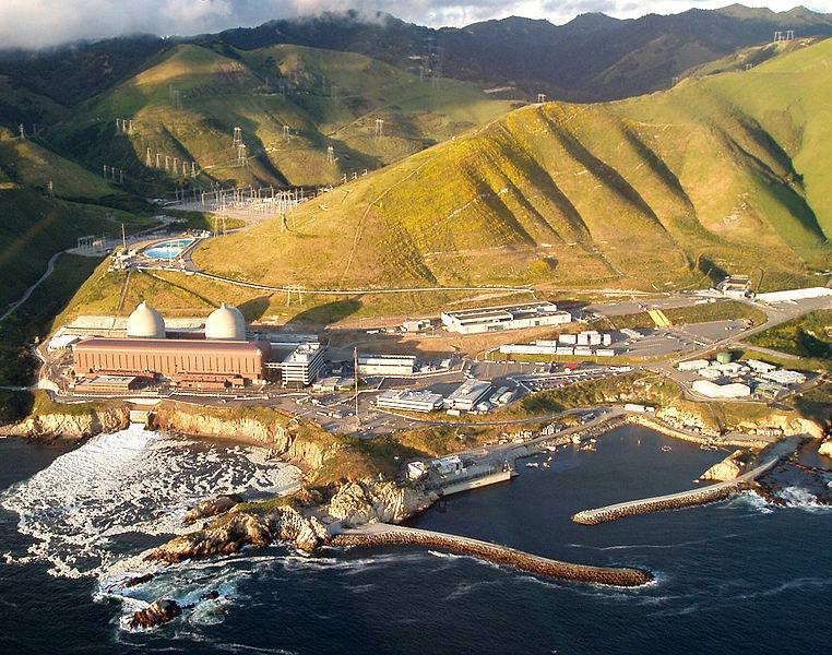

The Japanese did apparently plan for earthquakes and tsunamis at this plant. They had something like a 6 m sea-wall around it - they got a 7 m wave this time due to the unexpected magnitude of the event.
A lot of Japan's plants are along the coast - I suppose the reasoning was easy access to cooling water. I imagine in the future, they will build them further up, and build pipes down to the shore, or alternatively pay much closer attention to waterproofing the backup generators, or build newer generation plants that passively cool. There really isn't any part of Japan where they can build that doesn't get earthquakes. Furthermore, they don't have native coal supplies, so they had to rely on nuclear for a good portion their power.
To me it looks like insulation as well.
It is difficult to judge, as the picture is taken directly from above, but I don't see the wall; check the Google Earth images. Looks like the plant is open to the sea, with high ground behind (steep slopes are very well visible and they are behind all reactor buildings).
I am far from saying they didn't plan for an earthquake and tsunami, and I am fully aware they have not much choice. Still, putting the plant few meters higher seems not that difficult, especially in this particular place. Using Google Earth data ground is 40 meters above sea level less than 300 meters from the reactor buildings.

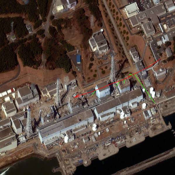

The reports are indicating that hydrogen escaping into the outer shell of the reactor building caused the explosion which blew off the top of reactor building 1. The steel frame atop the reactor building 1 is visible to the right in the photo at (http://www.greenpeace.org/international/ReSizes/OriginalWatermarked/Global/international/photos/nuclear/2011/digitalglobe-flickr-Fukushima-Japan.jpg) (source reliability considered but the photo does not appear to have been edited).
Reactor building 4 to the left of the picture reportedly suffered from two fires, at least one of which was attributed to lube oil combustion. However in the photo the majority of the lower and upper east facing wall of the building appears to be blown out between framing, while the roof appears to remain in place, and as the photo in post 305 shows, much of the cladding wall of the upper north facing wall of building 4 remains. That result would appear to indicate damage other than form a lube oil fire, and from a different sort of explosion than damaged building 1.
If the building 4 explosion were due to hydrogen from the spent fuel pool or from steam venting from the containment rising why would the roof and top wall cladding remain while the lower east facing wall appears to be blown out? The JAIF report for 1600 hours on March 17 suggests Unit 4 containment integrity is not damaged. Do the remains of building 4 suggest an explosion lower down in the containment and a major breach of the containment (or in the torus if it is not considered part of the containment)? Or is there a more likely explanation for the pattern of building 4 damage?

Yes it's difficult to judge elevation from that image but I can see the rocks that build up the seawall there.
Borek, myself and others have been saying the same thing previously in this thread. I know it sounds like a case of 20/20 hindsight but I'm also very surprised that a nuclear power plant would be so poorly protected from a tsunami.
In my opinion the quake was unavoidable but the tsunami was optional. And it's that "option" that is costing them so dearly now. I can see no reason why the plant couldn't have been situated where it would be safe from a 15m tsunami.
The size of the explosion depends upon the amount of hydrogen and how well it is mixed (on not) with O2 at the time of ignition. Bear in mind that steam would also dilute the H2 in air.
In Units 1 and 3, the hydrogen vented into the upper containment from the core, so perhaps steam did not dilute the hydrogen (hydrogen is lighter than steam), and the hydrogen-oxygen then ignited.
