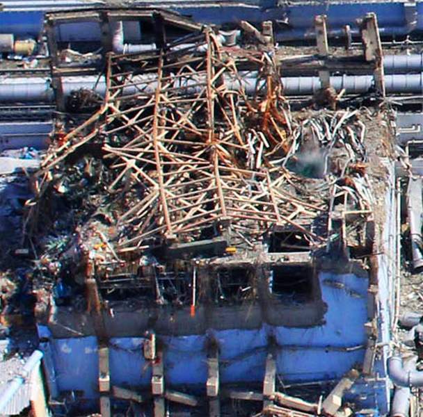

In this image taken by T-Hawk drone aircraft, Tokyo Electric Power (TEPCO) Co.'s crippled Fukushima Daiichi Nuclear Power Plant No.1 reactor building's rooftop is seen in Fukushima, northern Japan April 15, 2011 . We have found one thing out for sure . That the T-Hawk drone is not worth the money that has been spent on it . I can't believe how bad the pictures and videos taken with it are .

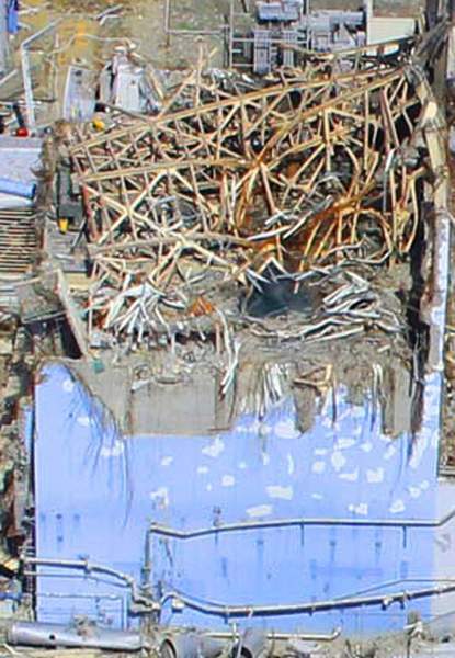

http://cryptome.org/eyeball/daiichi-npp9/daiichi-photos9.htm
And pict32 is a very interesting photo of FHM 4. The FHM has been "de-masted". Perhaps pretty strong evidence something violent happened within the confines of the SFP?
Pict25, Bldg 3 looks pretty similar to the elevator shaft, cask transfer pool, SFP layout suggested earlier. Steam still venting from the general area of the fuel transfer chute?

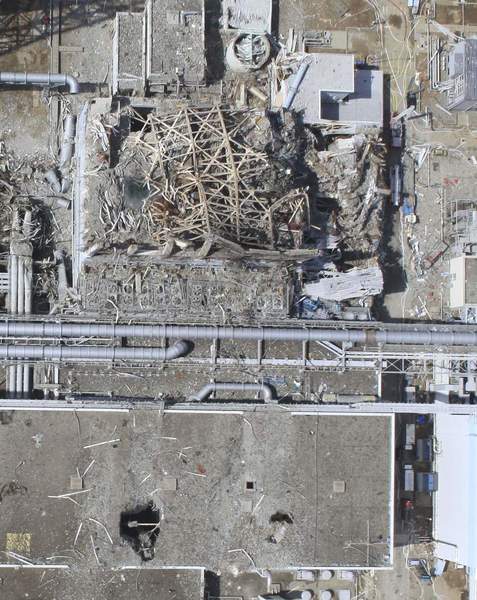

I've stuck together the pieces of the roof structure of unit 3, by locating the single parts, then putting images of those in a 6 by 4 matrix, in the positions they were in before the hydrogen, and the following steam explosion. The result of my effort is this:
There's an html version of the same thing with the images in the original resolution, at
http://www.gyldengrisgaard.dk/fuku_docs/roof3.html
