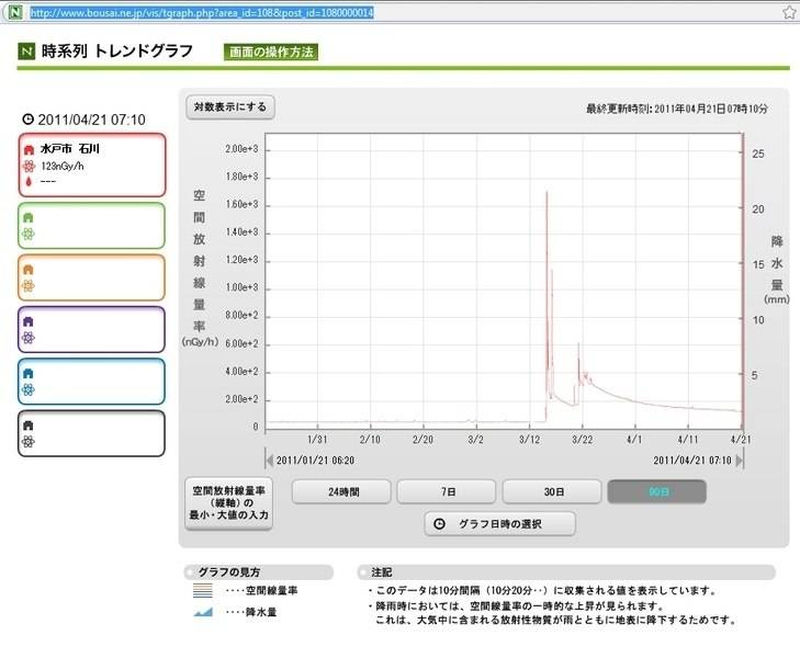

PietKuip said:
That is not quite true. When winds are inland, there is fallout in Ibaraki and as far away as Tokyo; see pages 4 and 5 of http://www.slideshare.net/iaea/radiological-monitoring-and-consequences-19-april-2011
The increases on April 9th, April 10th, and April 12th as shown on pages 4 and 5 of that document
A) are quite small as you can see on page 2 of that document
B) can you rule out that they are caused by rainfall depositing onto the ground "old particles" that have been flying in the air for weeks, rather than "new particles" extracted from the nuclear plant a few hours before their arrival at that measurement location in Ibaraki prefecture ?
For example, I attach the measurements at the Ishikawa district of Mito city, Ibaraki prefecture (Source : http://www.bousai.ne.jp/vis/tgraph.php?area_id=108&post_id=1080000014 - you need to adjust the maximum level by clicking on the 最小・大値の入力 button to a suitable value like 2000 nGy/h and to click on the 90 days button : 90日). I think the 600 nGy/h peak shown on March 21st was caused only by rain, without being related to any specific incident at the plant.
There are continuous emissions at the plant - see the smoke and the steam!
A kilobecquerel per square meter at such distances is a high level of fallout. It is consistent with wind directions. See the April 10 weather data for Mito http://www.wunderground.com/history...ml?req_city=NA&req_state=NA&req_statename=NA"
Thanks for the meteorological data website link. North-East winds are in line with your explanations. The rainfall seems to be 0 cm everyday so I don't think the rainfall data on that website are reliable, though.
I believe the wind was blowing towards Mito from Fukushima Daiichi that day.
Note that on 3/21, the wind was coming from the north-east: http://www.data.jma.go.jp/obd/stats...C%CB&year=2011&month=3&day=21&elm=daily&view=
Likewise on 4/9 and 4/10: http://www.data.jma.go.jp/obd/stats...90%85%8C%CB&year=2011&month=04&day=21&view=p1
[Add: Now I see PietKuip has provided similar data. I would add that 3/21 and 4/9 it was raining in Mito, 4/10 it was not. 4/12 it was sunny in Mito, and wind was from the north. To know if the (possibly curving) wind path links up with Fukushima Daiichi one really needs the 2-dimensional AMEDASU plots for the region, but they only seem to go back 2 days.]
I'm not in Mito, but from what I have seen locally, fallout from Fukushima Daiichi is only observed when the wind is blowing our way from there, regardless of rain. We have had both sunny and rainy days when the wind was not blowing towards us, with no rise in background counts. We have also had sunny and rainy days when the wind was blowing towards us, with a rise seen. I imagine the rain helps flush out the local atmosphere more efficiently, but I don't think there is a cloud of old radioactive particles hanging over eastern Japan to be flushed out by rain.
Thanks for finding the rainfall data for Mito with the "jma.go.jp" link.
On the plot for Ishikawa district of Mito ( https://www.physicsforums.com/attachment.php?attachmentid=34676&d=1303339897 ) the two highest peaks are for March 15th and March 16th. They are both related to incidents happening at the plant : the unit 4 fire and the unit 2 explosion on March 15th and the white smoke on March 16th: see page 16 of http://www.isis-online.org/uploads/...s/Accident_Sequence_Fukushima_31March2011.pdf .
So I think it is strange that we find another quite big peak at Mito (though smaller than the 2 previous peaks) on March 21st without any known specific trouble at the Power Plant on that day or the day before.
I strongly disagree with this assessment. The peak on the 21st was recorded at many stations and its only analog is the similar peak on the 15th tied to known releases and fires. The level in Ibaraki has been slowly descending since the peak on the 21st and has only recently receded back to the levels it was around the 20th of March. When it rains the level often wobbles slightly higher and lower till the weather clears.
Monitoring at the plant by TEPCO was pretty rudimentary for the first month - mostly driving around with a hand-held meter from time to time - and they didn't have any way to keep track of what was happening at the plants it seems. The explosions of units 1 and 3 were recorded by news crews - otherwise there wouldn't be any visual record. What happened at unit 4? No one knows. How many explosions were there? No one knows. What was burning at the various units? Where has the steam been coming from - no one knows precisely...
Perhaps because it rained all over Japan on that day.
The peaks associated with rainfall are nothing like the peaks on the 15th and the 21st. The later are characterized by an abrupt rise to very high levels followed by a smooth exponential decay. The problem is that TEPCO simply has no idea what was going on at their facility. The radiation monitoring system went down with the power outage and wasn't restored for many weeks (maybe it still isn't fully operational). There was no attempt to put cameras in place to monitor the reactors, on-site inspections were sporadic with many evacuations. The whole response was characterized by shock and confusion for quite a long time. Many of the official pronouncements about the state of things were mere guesses based on very little hard information. This is why there is still so much uncertainty about what the situation is - other than the fact that the cooling water injection has been successful enough to keep further rapid deterioration from occurring. The longer they keep it up and nothing bad happens the cooler the remaining fuel becomes...slowly, very slowly now.
Since the direct leaks to the ocean have been plugged contaminated water is building up throughout the site and leaking into the water table. It may be that the ground subsidence following the quake has raised the water table as well. First class mess really.
Edit: Unit 3 experienced a rise in pressure on the 20th and TEPCO said they might need to vent it, however the pressure subsequently rapidly fell without intervention. I would be willing to make a serious bet that it 'self-vented' at that time leading to the radiation spike in the surrounding region.
If nobody has any idea of what happened on March 21st, then it could happen today or tomorrow again. To rule out that something can happen again you need to understand the causes that made it happen.
See the edit to my post above for a possible cause.
There was also an observed outbreak of grey-ish smoke coming from Reactor 3 on the 21st.
Also, white smoke from Reactor 2 on the same day.
