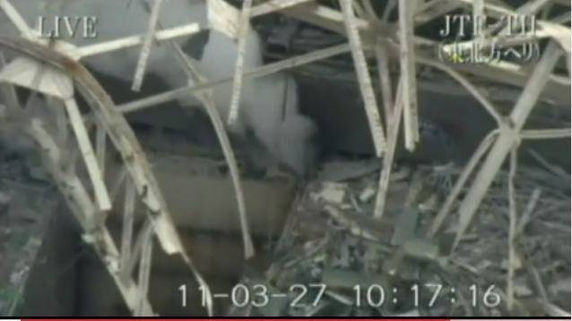

Well, the mystery thickens.<..>
What was the date of the photo showin the Mickey Mouse ears?
It was March 11th, at approximately 16:00. It is a frame from the video shot from a helicopter shortly after the tsunami, see for example this version of the video:
http://www.dailymotion.com/video/xhsf3e_new-film-of-tsunami-aftermath_news
There's perhaps disappointingly little mystery in it. If one takes account of the poor quality of the video from March 11th, and its being shot in a more oblique angle, it appears to be showing the same as the photo we have from March 12th:
Note: The image in the center has been subjected to the shearing/perspective tools of Gimp, in order to correct for the more oblique angle it was taken, so as to ease comparison.
Also the stair is still to see. On the next Fotos, a few days later, the stair is away?? How does is work?

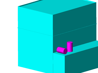

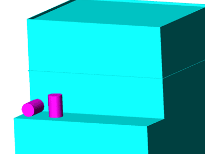

MiceAndMen said:
Nice try. According to this http://www.irpa.net/irpa10/cdrom/00584.pdf the core shroud is approximately 4.5 meters in diameter and about 7 meters high. So it would more closely resemble the attached pictures.
View attachment 35063View attachment 35064
It's almost a perfect fit.
No malice was intended. I honestly don't think it is possible to get the replacement core shroud through that hole in the wall in one piece. And even if you managed to do so, the troubles getting it to the service floor would not end there ..
The amount of room to work between the wall and the SFP could be a problem for this arrangement. That is certainly true. Thus, my thirst for more and better blueprints. I was frankly surprised when I quickly whipped up the core shroud cylinder and placed it on the low roof. There could be other reasons why they needed a 5 x 5 m opening (or whatever it is).
I would put that figure slightly lower at 4 x 4 m, but let's not quarrel about that, I think we can agree that if it is a fit, then it is a tight one.
I think the shape that appears to be a hole in the wall, after the green box has gone, encomprises not just a hole, but also to the right, left and above the actual hole a jagged edge surrounding it, where wall panel paint/concrete has come off. At the bottom edge we have the more massive vertical concrete structure of the wall, roughly corresponding to the separation between 3rd and 4th floor. Visually, after paint and concrete has peeled off of that piece of concrete it is also liable to visually give the appearance as being a part of the hole, but we know for sure, that nothing has made a hole in it (and nobody in their right mind should contemplate to do so, since it would risk compromising the stability of the building.)
It is curious that with all the technical details we know of the shroud replacement procedure, that we don't know how the shroud gets to the service floor. Do we know that it is being brought in, in one piece? From diagrams I've seen, the construction of the shroud itself involves the welding together of several cylindrical 'slices'.
I'm afraid there's not much mystery about the staircase either, sorry. The staircase appears to have been a feature of unit 4 for as long as most people would be able to remember. The staircase leads from the ground to a platform from which service can be made on some ventilator/cooling equipment installed on the roof between unit 4 and its turbine building.
Based on the poor quality imagery of the first helicopter video made after the tsunami, on March the 11th, I'd initially made the assumption that the upper part of the staircase had suffered damage at that stage. However, prodded first by Jorge, then by a photo I found, which appears to have been taken between 8 and 9 am on March the 12th, I no longer think that there can have been any major damage to the upper staircase, until the explosion in building 3, which -- quite unmysteriously -- no part of the staircase seems to have survived.
What gave me the impression from the photo from March 11th that something is missing of the upper part, now I hypothesise, may be just some light debris lying there blurring the view to it.
And the fact that the upper part of the staircase has turned clearly visible on the photo from March 12th, could be just because an employee of Tepco during the evening of the 11th or the morning of the 12th had wanted access to assess damage at the greenbox and had been clearing his way for debris up the stairs. An employee of Tepco _should_ have wanted to do so.

OK, here are the Mickey Mouse pics again:
[PLAIN]http://www.ic.unicamp.br/~stolfi/EXPORT/projects/fukushima/povray/blueprint/foto/edited/src/reactor4-E-scaff-2.png[PLAIN]http://www.ic.unicamp.br/~stolfi/EXPORT/projects/fukushima/povray/blueprint/foto/edited/out/reactor4-E-scaff-2-A-e.png
(A) I see there a tank - white, cylindrical, horizontal, with two hemispherical caps. But there may be something else at the North (right) end.
(B) Seems to be a platform below the tank, with a railing and/or some equipment hiding the lower parts of the tank.
(C) The central part of the scaffold seems to be offset to the East. A ladder or stair leading to the platform (B), perhaps?
(D) Projection of floor 4 on the outside of the east wall. I have truncated the line for clarity; AFAIK the 4th floor slab spans the whole building, up to the corner, except for the reactor and SFP cavities. (Floor 5, the service floor, is level with the pipe running across the wall.)
(E) Projection of floor 3 on the outside of the east wall. The projection is actually hidden behind the turbine building.
I was surprised at the position of floors 3 and 3 in this picture; I was expecting them to be a bit higher. But that is what the blueprints and my arithmetic say.
[PLAIN]http://www.ic.unicamp.br/~stolfi/EXPORT/projects/fukushima/povray/blueprint/foto/edited/src/reactor4-E-scaff-4.png[PLAIN]http://www.ic.unicamp.br/~stolfi/EXPORT/projects/fukushima/povray/blueprint/foto/edited/out/reactor4-E-scaff-4-A-e.png
(A) I guess the two ends of the tank are here.
(B) My guess is that this dark spot is a piece of equipment or scaffolding in front of the tank.
(C) This blurred spot is where the top of the staircase should be. It may have been lost by the MPEG encoding.
(D) These seem to be the pipes/cables that, in latter pictures, connect to the Big Grayish Closet on the south wall of the building, below the window. Does it mean that the Big Grenish Closet is not the Mickey Mouse scaffolding, but a separate Mystery?
(E) Corner line of the main building. It actually extends all the way down to (C), the parapet of the terrace.
(F),(G),(H) - projections of floors 5 (service), 4, and 3 on the outer face of the East wall, computed from the blueprints.
(I) Possible roof or raised floor above the terrace floor.
According to the blueprints, floor 3 should be at the same level as the floor of the terrace in question. Yet in this photo the latter seems to be a couple of meters higher than floor 3. Perhaps there is a roof or raised floor on the south half (I) of the terrace, around the air condintioning units?
If the concrete floor of the terrace is indeed at level (H), then the Mickey Mouse structure is probably taller than we thought; perhaps 8 meters or more.
