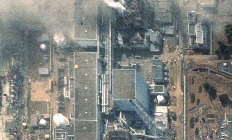

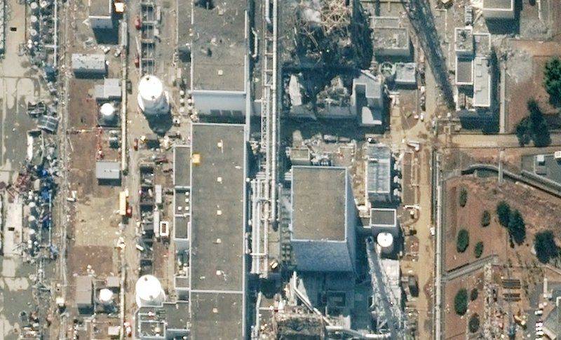

PietKuip said:
The elevation of the site may have moved downward because of the earthquake.
Looking at the webcam before and after the quake it is clear that something has given in. Before the quake, the webcam could see much more of the reactor buildings. After the quake either the knoll where the webcam is sited, or the NPP, or both, must have moved downward relative to the elevation of the treetops inbetween now blocking the view. See:
http://www.gyldengrisgaard.dk/tepcowebcam/tepweb20110311.html

  • #5,628
Well the difference between before and after is very surprising indeed... but i really doubt that the plant, but also for example the area where all the cooling water from the plant is released into the sea, could have lowered so much in comparison with the viewpoint of the webcam, this is huge difference!
I would imagine more a scenario where the webcam has moved down because of the quake (see the change is between the 14h00 and the 15h00 image).
