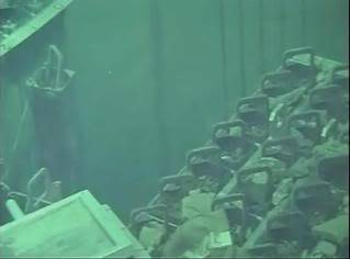

Any reaction welcome:
Unit 4 SFP. Is this a picture of melted fuel assemblies?
1. Take a look at the attached image of the Caltech presentation mentioned in a post a few days ago. In the graph, you can see that the two most intense radiological releases followed events at the unit 4 SFP. (I believe as measured onsite, but the presentation is not abundantly clear)
2. Take a look at the attached image from the unit 4 SFP.
3. If you were TEPCO, which assemblies would you check first? The ones that were most recently taken out = hottest = most likely to melt?
4. Would you know where these were located in the pool (yes) and would likely check them first?
5. Recall the Gundersen demonstration of the zircaloy heating, and subsequent change in the characteristics of the metal
6. I’m not sure if the “handles” of the fuel assembly (the part lifted by crane) are also zircaloy?
7. You can clearly tell in the picture that some of the assembly handles are considerably less reflective and dull. It would make sense if this was due to light obstruction, but the light seems to be uniformly cast throughout the rest of the image, and equally reflective in other parts of the pool.
*Note – I have been following since the beginning. Apart from the news aspect, read this forum has been an excellent lesson in critical reasoning. I am only trying to understand what has happened because I find it fascinating this event has pushed us collectively to the edge of our knowledge. I only post on this because I have thought about it critically, and cannot arrive upon a good answer.

  • #7,012
I explained what is labelled on that picture as being damaged grid & damaged vertical row in the past. This is not actually damage to the fuel assembly storage racks, it is actually handles/lugs that are part of the racks themselves (as opposed the the fuel handles), handles that protrude above the rest of the rack. And so when viewed from that angle at that low resolution, it can appear like a distortion to the grid.
If you watch the 2nd, longer unit 4 fuel pool video then you can see these more clearly, along with other features.
edit - I attach an image from the 2nd video that shows these handles clearly.
