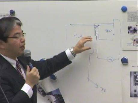

AntonL said:
Tepco have been reading this forum for ideas, I postulated this a month ago :smile:
and again later
That was just too easy,do another one cos I can't quite believe Tepco are that dumb. Then again on reflection ,no need.

~kujala~ said:
Nice work, Anton! :approve:
(BTW: I remember there were some counterarguments against your theory. Now that TEPCO has adopted your theory is there any more validity in these counterarguments? TEPCO engineers must know their plants so their evaluations about possible theories have a certain level of assertiveness, which the outsiders lack.)
i still don't buy that. there were more than 24 hours between the explosions of #3 and #4...
and we have this information ('tepco says...') only second hand. the same quality of information as we had before for a contradictory explanation (explosion in #4 blowed away a gate and reflooded the SFP).
let's wait and see ;-)

jlduh said:
If they say now truth, the only explanation is see is that... they were lying before!
I would not accuse TEPCO of always telling the truth, but there are more explanations for this than mere lying.
They learned something when humans were able to enter reactor 1 building, just as they learned something when they increased the water rate but levels of water did not rise. This allows them to be a bit more certain about what happened.
Certainly they did not seem to like the word meltdown being used in the early days, but they didnt do very much to discourage the theory, only to discourage ideas that the core may have left the rpv, so depending on what definition of meltdown people were using, it is not necessarily wrong for TEPCO to dislike the word. I don't think their position has changed completely. More detail on the timescale, and not hiding behind %age of fuel damage assumptions anymore, but in other ways similar to the past. They say the core is still in the reactor vessel, same as before. And they have long said that they think water is cooling the fuel even though water levels are below what would be top of the fuel. Maybe in the past they wanted to give impression that fuel was now half melted, so half its original height, with water still high enough to cover it. But now they have water measurements that are much lower, so they adjust the assumed height of the fuel downwards so that water still covers it.
  • #7,335
The full theory for #4 includes also the explanation for the fires. Now TEPCO thinks that the explosion may have caused oil to catch fire:
By assessing damage to the building, TEPCO says the blast was likely due to a hydrogen explosion, and that oil may have triggered fires after the blast.
http://www3.nhk.or.jp/daily/english/16_02.html
It was not so long when somebody said here:
Is it possible that the explosion could have immediately heated a small part of the oil over fire point and also ignited it? The result of this would be a couple of fires here and there that would be extinguished by itself? The explosion itself could be explained by AntonL's theory (radiolysis) or something else.
:wink:

triumph61 said:
According to Tepco, hyrogen produced in the overheating of the reactor core at Unit 3 flowed through a gas treatment line and entered Unit No. 4 due to a breakdown of valves. Hydrogen leaked from ducts in the second, third and fourth floors of the reactor building at Unit 4 and ignited a massive explosion.
http://online.wsj.com/article/SB10001424052748703509104576325110776621604.html
Very nice domino effect (one more) if this proves true.
Would be interested to see what was the rated probability of this event in the safety assessments... I already mentionned the fact that some of these safety studies are lacking seriously on this domino effect side (and "thinking the unthinkable", as they said recently In France for the reassessment of french nuclear plants to be done ASAP)
It seems god plays with dices and wins much more than expected by experts in this desaster.
