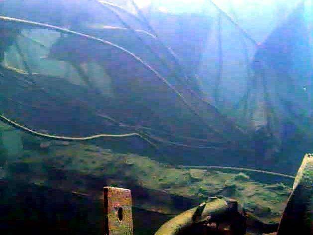

SpunkyMonkey said:
Any ideas on what's the large flat object that's smashed down across the crane's bridge?
No, but it has two features which may aid an ID. Along its top, which is well sprinkled with rubble, can be seen three regular cylindrical shapes at regular intervals (wheel pins is my first impression, but those are not always right). Also at the top, but on the side of the object that is facing the camera, there is a regular pattern bright/dark/bright /dark etcetera . The dark fields could represent just cavity in the dark, but they could also be fair dinkum darker surface fields. Considering the regularity the object displays it is not likely a chunk of the wall.
closeup to top of object:
from the distance, and at a different angle:
Nice images, you can really bring out the details! Right, I don't think this is a wall. I have to say the easiest thing to guess it is is what was on top of the bridge span it is rather on top of now, the trolley. But were there enough trolleys to account for all them that I'm seeing, lol!
Though as you note the trolley had a couple levels, but if that big object is the lower level and the object I suspect is the upper level actually is the upper deck, then it seems maybe they were torn apart. As odd as that sounds, I don't know what to expect at this point. The bridge is in much worse shape than I'd have expected. And how about the crane's ladder entangled with a roof girder! That mess is like a surreal bad dream!
If you imagine this on the other side of the FHM and with the "stops" torn off it's not a bad match to this.
We can't see if there's a middle wheel in this image which would have helped.
Right, it is not a bad match at all. It would be reasonable to think the other side is similar but that side is well hidden in all photos. Anyone got drawings of a classical Toshiba FHM? ;.)
We should also be cautious to accept those tree wheel pins, and we can certainly not exclude that e.g. the one of the middle is just a piece of rubble caught in our minds fabrication. Maybe they all are? It is difficult to not see pins after first having seen them, though.
