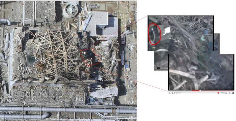

  • #2,196
curious11 said:
Sorry if this subject has already been put to bed. I thought I'd use the latest hi-res images to locate the position of the suspected sf-rods from an earlier video.
So, here they are. Any idea what the feature hi-lighted might be?
https://www.physicsforums.com/attachment.php?attachmentid=33787&stc=1&d=1301584597
@Curious
You have indeed located the rod-like objects in the latest areal imagery. This was taken from the first helicopter fly over, and by way of disclosure, "Photoshop'ed" to correct color levels, contrast, and sharpness
http://i306.photobucket.com/albums/nn270/tcups/903a9527.jpg
And here is my best SWAG at the layout of the top floor, see post #2089
https://www.physicsforums.com/attachment.php?attachmentid=33731&d=1301513587
which puts the "rod-like structures west of the location of the equipment pool, I believe. I am not sure of the confirmation of my layout in the second image, however.
gmax137 said:
That looks like a bunch of 3/8 inch stainless tubing to me. There's typically miles of that stuff in a plant, used for instrumentation.
Yes, but not anywhere else in a fairly tight cluster that I can see. And in the midst of explosive destruction, they seem awfully rigid -- not bent like lots of the rebar seen in other images.

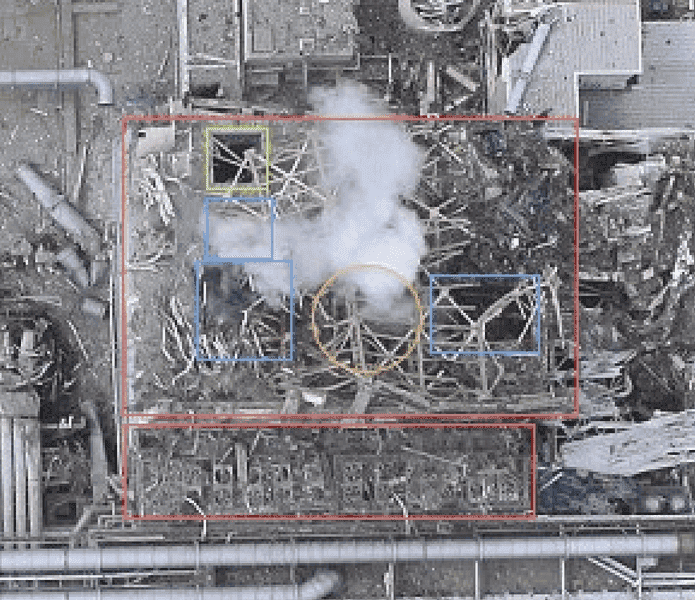

Thanks FRED for these excellent quality pictures, taken it seems the 20th and the 24 th of March by a Canon KissX4 (which is in fact the 550D in Japan) and a Canon 5D MarkII (based on the exifs of the pictures... i practice photography so it's an habit to check that).
I guess these are the ones take by the Japanese Air Service in Nigata with the small plane used also for volcanoes. Where did you find them by the way?
As everybody i started to review them in detail. On buiding 3, i have something which ressembles to the cover of the pressure vessel, on this capture:
http://www.netimago.com/image_184641.html
extracted from this full res image:
http://www.netimago.com/image_184667.html
Do you see this big yellow round part which is right behind the pillar n°4, right in the middle of the building from this view taken from the East side?
I've been at first in favor of the theory of the concrete plus being ejected by the huge vertical explosion, but looking at the top and at the way the explosions precisely happened on the video, I rejected this idea. Now i see this picture and I wondering what this part is, right here...
And then, where would have gone the big concrete plug? Just moved sideways maybe?
I'm in the position of really saying that there hasn't been big ejections at the vertical of this point above the reactor well. But maybe displacement?
Could it be that there may be a second cover that was on the top floor for maintenance reasons for example?
It does not to me.
I see rumpled elongated narrow sheets that were made that way by physical shock, like from that explosion.
They appear to be (approximate guess) ten times to fifteen times wider than they are thick.
For them to have taken on such a rumpled shape their substance must have some malleability, much like lead.
What ever fits that description is what it is.
I think they are fuel rods that have been through one hell of an explosion.But what the hell, I am not a nuclear engineer. I just go by what my eyes tell me.
  • #2,203
I post here a series of screenshots of the video showing the explosion of reactor 3. Take the stack vent (the white "antenna") as a reference, it is perfectly aligned with the left edge of the reactor N°3 building.
http://www.netimago.com/image_184705.html
Ok,
FIRST EXPLOSION or FIRST TWO EXPLOSIONS?
a) BIG ORANGE FLASH AT THE LEFT SIDE TOP OF THE REACTOR. This is South side. So it starts with probably an H2 explosion in the top rop, close to SFP.
b) BIG DARK GREY BURST ON THE LEFT SIDE OF THE BUILDING (North)
http://www.netimago.com/image_184715.html
AND THEN (SAME EXPLOSION OR A SECOND OR THIRD ONE?) BIG VERTICAL DARK GREY BURST EMERGING VERY CLOSE TO THE REFERENCE "ANTENNA" (then it moves parallel to the right of course because of the wind), SO MORE ON THE LEFT SIZE OF THE BUILDING (NORTH)
http://www.netimago.com/image_184724.html
Then the vertical grey burst continues to rise very high in the sky (i estimated at around 500m based on the fact that the reactor buiding is around 50 meters high). But it's difficult to see where are the big chunks at the top.
http://www.netimago.com/image_184731.html
http://www.netimago.com/image_184733.html
For reference the complete video is here:
I put also the Hi Res pic from the top of the reactor to try to correlate what the explosion says with what the debris can say:
TOP VIEW: (North is right side, South left side)
http://www.netimago.com/image_184741.html
FROM WEST TOWARDS EAST (North on the left side, South at right)
http://www.netimago.com/image_184742.html
FROM EAST TOWARDS WEST (South on the left side, North at right)
http://www.netimago.com/image_184743.html
PERSONAL CONCLUSIONS: to me pictures of the debris correlate with pictures of the explosions (what a scoop hey!). On the south side at the top we see the place of the first flash above the pool, with a big hole and around the metal is heavily bent. On the North west side, this has been the place of the big vertical burst: heavy destruction of the building, with some holes still visible from the bottom. The metal structure of the roof which stays in the middle seems to have been displaced towards the south by the vertical burst. The south side of reactor n°2 has been crippled by the lateral debris projected by the lateral burst on the North side at N°3. We can also see that Building n°3 is more heavily damaged on its west side than on its east side (one level more still there).

I've attached one such still image to this post.

Has anyone seen the stills lifted from this video that seems to show the top of a reactor vessel sitting at a 45 degree angle?
I have seen the video, but I am far from convinced that the plug is 45º askew from the top of the reactor containment at Unit 3.
It was not the overhead crane that fell in the SFP3, it was the fuel handling equipment.
The steam may be venting from a slot-like structure (the fuel transfer chute) on the north side of the SFP3
I believe these may be the stills from the video in question (my screen captures). Please correct me if not so.
Question for someone who knows:
Is the reactor plug (or the segments that make up the reactor plug) held in place only by gravity when the reactor is operating?

To Justguessing:
the top cover of the pressure vessel (big and yellow) shown in this video is the one of reactor No4 and there is nothing abnormal to see it here because the reactor was on maintenance, so the top cover was removed with no fuel in the core. I was talking about reactor No3 where i have the impression to see something ressembling strangely to a cover of pressure vessel."the top cover was removed with no fuel in the core" did i say?
(well, are we sure that there was no fuel in the core at No4 by the way? We know that it was down but if my understanding of operations is right, when refuelling they just change maybe one third of the fuel, no?
Could it be possible that there was still fuel physically in the open core when the accident happened? So in this case this fuel may be in the same situation than in the other reactor with a decay rate much more advanced of course, because shut down before tsunami. IS IT POSSIBLE? Then of course it would have been fully under the water at the moment of the tsunami but then what happened after if water leaked from pool? It could have been hot too, don't you think? Could this explain why there is so much damage on building No4, even at the low stages of the building? Didn't we conclude to quickly that the reactor was OFF while some fuel was still inside?
TCUPS: try with an other browser maybe, it works perfectly here (don't know for other members?).
The photos you posted seem to show an empty, or nearly empty SFP. The high-res photos that recently came out look like the fuel handling equipment went over the north side of the building. But I don't see any evidence of equipment going into the pool. Maybe I am looking at it wrong.
EDIT: or maybe the green color I am seeing in the SFP is the handling equipment. I saw some other green equipment around the north side and thought that was it.

It is this grab with the time code 10:12:11 I'm interested in.
I think that is some of the normal testing or equipment rigs. Someone posted a shot a while back of the equipment floor from the past and there were lots of these big round things around the floor which I assume are different rigs for diagnostics or repair, or something.
EDIT: here is the post with the photo of a plant floor: https://www.physicsforums.com/showpost.php?p=3210916&postcount=1344
  • #2,215
The top right corner of the 10:12:11 image look like the rings of the vessel to me.

TCUPS I try to reload the picture showing the "something like a cover pressure vessel in reactor 3" through the "attach" function of the forum, maybe it's better for you?
Ok it's attached as thumbnail but it's smaller than my original...
  • #2,217
jlduh said:
TCUPS I try to reload the picture showing the "something like a cover pressure vessel in reactor 3" through the insert image function of the forum, maybe it's better for you?
I think that is part of the overhead crane system. The two large beams of the crane are directly below this feature (and the feature seems to be right in the middle of the beams - maybe it is part of the drive motor assembly of the crane).

All:
The overhead crane was reported to have fallen through the north side of the top of Bldg 3 and then down, crushing the adjacent building below.
The fuel handling equipment is green in color and, I believe, only shuttles over the SFP and core service access whereas the crane goes from side to side of the building, east to west. The crane is used to hoist the plug structure(s) from the primary containment and to lift the drywell cap (the big yellow-orange cap seen sitting out in Bldg 4). The fuel handling equipment is only for lifting the new and spent fuel rod assemblies. The fuel handling equipment never lifts the fuel rods out of the water. They are transferred under water, through the fuel handling chute and into the reactor while submersed.
It has been my conjecture (unconfirmed), from early on, that if a blast occurred in the primary containment of Unit 3, the "weak spot" would be the fuel handling chute gate, not the massive cap. The seals on the gate were pneumatic and powered by electric pumps (no electricity at the time of explosion).
A blast of hot gasses venting explosively through the fuel handling gate would enter the SFP, possibly vaporizing water in the pool and leading to a secondary steam explosion, or possibly igniting a hydrogen blast, as occurred in Unit 1, or both. The depth of the SFP3 would act like an acoustic lens, to focus the force of any blast occurring from the SFP3 upward. Hence, a two component explosion, fireball out the south side, vertical blast upward over the SFP3, not at the plug, and a secondary blast of hydrogen + oxygen causing a blow out of the building
The venting steam would be coming from the gate/chute area, under the plug. The "stuff" in the SFP3 may be the fuel handling equipment on top of the rods.

TCups said:
All:
If you look at the high-res photos posted earlier, there is an overhead shot of #3 that shows two large beams running east to west, approximately in the middle of the building. These appear to be a meter or more wide and they are parallel just like one would expect in an overhead crane. It could be something else but it sure looks like a crane to me. But I think the rest of your scenario seems very plausible to me.
