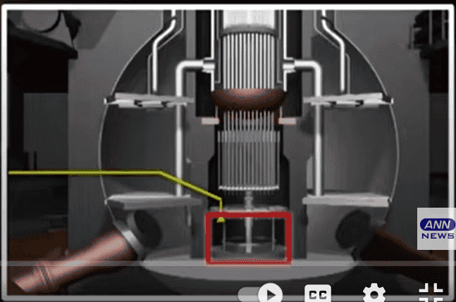

Charles Smalls said:
(34:03) According to this graphic, they suspect hot molten fuel somehow made it's way into the suppression pool and burned through the bottom of the torus to contaminate and leak water from there.
(34:09) They seem to be experimenting with different concrete consistencies and mixtures so they can get a mix to pipe into the suppression and plug the suspected leaks.
There was speculation on the thread in 2017 on exactly what this image showed. Clearly a suspected problematic leak in the torus they hoped to plug, but the bright orange colour they used to depict it was unclear. It may have been representing fuel, but at the time we concluded it was simply using a 'hot' colour by coincidence to highlight a suspected leak. If we go to TEPCOs new 23/05/2022 ROV video, we see a lot which may actually be relevant to this. Ignoring the severe pedestal spall damage for a moment, look bottom right at 2:12 and 2:20. Distinct layers where a 'crust' has formed above a material no longer present, leaving a void. The material has since headed off toward the JDs and left this curious gap or hollow space behind. It looks for all the world like a https://caves.org/virtual/virtual_tube/birth1.jpg, where molten material has passed on, leaving a thin crust of material 'floating' above.
Impressively, the ROV follows these crusts and material build-ups which have pilled up against the JDs, even going so far as to enter JD-D to film the other side (2:46). The high amount of noise and sparkle indicates the presence of high radioactivity, but more tellingly, notice that in JD-C, D and E, the video is edited to cut just before the camera pans round to film vent pipe and pathway down to the WW (2:54). In an earlier ROV mission, we see the full pan around of JD-G, but none in these three. As JD-C,D and E are pretty much directly opposite the pedestal opening, I speculate that the molten fuel would have flowed and spalled its way straight into these vents, causing a large amount of severe damage down to the WW which TEPCO don't wish to publicly disclose at this point. It's also possible the experts who consulted with NHK to produce that 2017 special suspected this all along (wish it was still available). That would align well with those graphics. What all this means as far as the 7m thick basemat, with the fuel likely taking a shortcut around it to down under the WW, and whether this is also the case in the other 2 units is still unknown. Probably not in unit 3 as the it still holds water quite well, but very likely in unit 2. It's difficult to build a complete picture as TEPCO is still being selective with the images it discloses, but I think this confirms the most likely route for possible ground penetration leading to the persistent ground water contamination issues they've been battling. Difficult to see how best they recover fuel that's gone as far as to leave the containment entirely. Hopefully we get a similar ROV investigation of Unit 3 soon, and some numbers of this one to estimate likely presence of local fuel to see exactly how much went where.

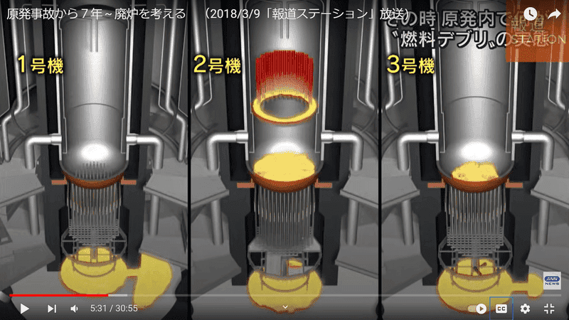

- So indeed the 2017 movie you mentioned is gone private but it seems NHK keeps refreshing that with new information every year. there should be a 2021 version but it seems to be pay per view, only on NHK site. I was able to find the 2018 version of that video, which has interesting images and information, too. It is in Japanese but closed captions help, to a degree.
At 6:50 they imagine the fuel melting process, the molten stuff goes at the bottom and stays put. Doesn't rise too far up...
8:47: the handle of a fuel bundle seen in the solidified deposit
9:20 estimation of the thickness/height of the deposit, about knee-high
16:16 and after - images from Reactor 5, which is similar to Reactor 2 which was depicted until now. Workers go under the RPV, we see the control rods.
A lot of discussion, experts and workers' opinions, including comparison with Three Miles Island (where things were nowhere as difficult), and realization of the difficulties of the task of decommissioning.
- A similar video but more recent (Feb. 21 but includes images from 2018 too) is here. Again at 5:56 they go under the PCV of Unit 5, then go lower into the pedestal and at 7:50 talk about the thickness/height of the solidified deposit in Unit 2, estimating it at about 60 cm. *My thoughts seeing this: Is it high enough to support the idea of molten fuel going through the big pipes into the torus? Is it a case of slow and quiet rising up of a liquid mass, like water in a sink when the faucet is left open and the bottom hole blocked, and then starts pouring out through these pipes - or is it rather a violent phenomenon in which everything flies everywhere and in that case we don't have to think too much about heights and levels...
