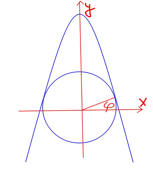

A wheel of radius ##R## rotates in a vertical plane about its fixed center. A speck of dirt detaches from a point on the wheel and, after a time interval ##T##, impacts the wheel at the same height. Determine the angular velocity of the wheel. The acceleration due to gravity is ##g##.
Find all possible answers.

There is a unique answer for the purely vertical motion: ##\omega=\frac{gT}{2R}##
$$-\frac{gT^2}{2}+\omega R T=0$$

Honestly, I'm a bit shocked by everything that's going on here.
$$x(t)=-R\omega t\sin\varphi+R\cos \varphi$$
$$y(t)=-gt^2/2+R\omega t\cos\varphi+R\sin\varphi$$
$$x(T)=-x(0),\quad y(T)=y(0)$$
Two equations, two unknowns: ##\varphi,\omega##

Correction: I had initially visualized a wheel translating upward while rotating. Re-reading the statement, the center is fixed and the wheel only rotates.
Therefore:
## h + v_y T - \frac{1}{2} g T^2 = h ##
which gives:
## v_y = \frac{gT}{2} ##​
For a detachment point at height h:
## v_y = \omega \sqrt{R^2-h^2} ##​
hence:
## \omega \sqrt{R^2-h^2} = \frac{gT}{2} ##​
Since the particle starts at:
## x_0=-\sqrt{R^2-h^2} ##​
and must hit the wheel again at the same height:
## x_f=+\sqrt{R^2-h^2} ##​
the horizontal displacement condition is:
## \omega h T = 2\sqrt{R^2-h^2} ##​
Combining the two equations:
## \frac{gT}{2\sqrt{R^2-h^2}} = \frac{2\sqrt{R^2-h^2}}{hT} ##​
which leads to:
## 4h^2 + gT^2 h - 4R^2 = 0 ##​
and therefore:
## h = \frac{-gT^2 + \sqrt{g^2T^4+64R^2}}{8} ##​
Finally:
## \omega = \frac{gT}{2\sqrt{R^2-h^2}} ##​
or, eliminating h:
## \omega = \frac{4gT}{\sqrt{128R^2-g^2T^4+gT^2\sqrt{g^2T^4+64R^2}}} ##​

##T## is fixed.

OP doesn't say that the speck detaches from, and lands back on the rim of the wheel. I visualized the wheel as a full disc, which makes the problem more complex.
Agree; the question wasn't clear, which is why I asked for clarification. An illustration would have been helpful.
Short explanation of my calculation in #11:
Ignoring the trivial vertical case, I considered a particle at height h on the wheel.
At detachment its speed is ## V=\omega R ## and, from that instant on, its motion is purely ballistic.
The subsequent rotation of the wheel is irrelevant: an equivalent problem is to freeze the wheel at the instant of detachment.
Since the projectile must return to the circle at the same height h, the only possible landing point is the symmetric point on the opposite side:
## x_i=-\sqrt{R^2-h^2} \qquad x_f=+\sqrt{R^2-h^2} ##
hence:
## \Delta x=2\sqrt{R^2-h^2} ##
which is the starting point of the derivation given in #11.
