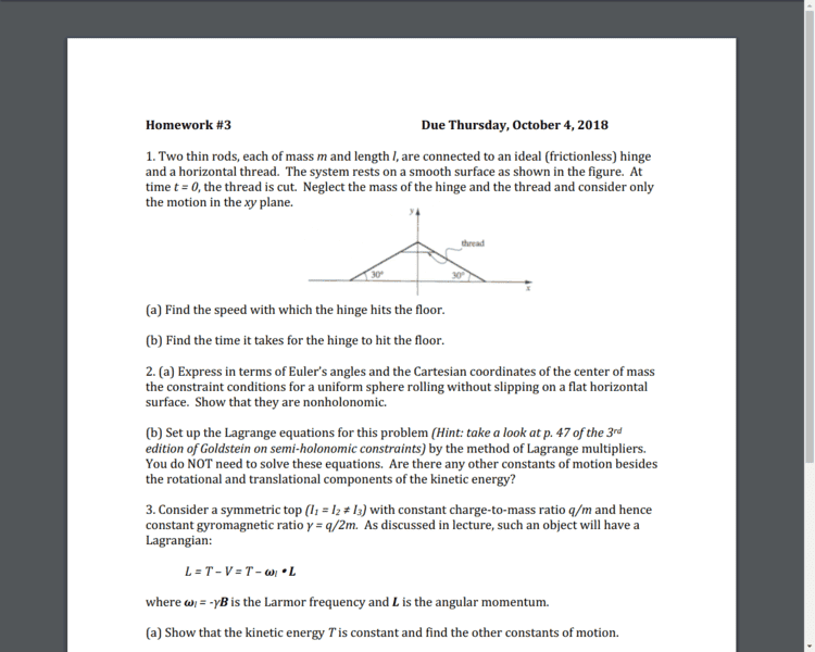

I uploaded the homework question. This is #1.
None directly given
My main difficulty with the problem is that I am convinced it is much easier than my classmates make it out to be. This is graduate mechanics so I'm pretty sure that the solution can not be this easy, but I don't know where I am wrong. All I am after is a discussion of the starting point so I can fix my intuition and hopefully get better. As a note, one classmate somehow calculated an inertia tensor in his solution which seems unnecessary. He argued symmetry made the solution calculable by examining only one rod with the CoM in the middle of the rod so there would be rotation and translation of the CoM.
The two rods connected to the hinge are perfectly symmetric. Thus the CoM of the system will be on the y-axis at ##y=\frac{l}{4}## (each rod's CoM is half way down its length so the two combined would be on the y-axis). The only force acting on the system is gravity which is acting on the CoM of the system. Thus the problem is essentially a particle (the hinge) being pulled straight down by gravity a distance ##\frac{l}{2}## where ##U=mgy, U(min) = mg\frac{-l}{4} ##and ##U(max)=mg\frac{l}{4}##. ##T = \frac{1}{2}m\dot y^2##. And the rods are relegated to being part of initial conditions to solve the equation of motion. So the Lagrangian is $$\frac{1}{2}m\dot y^2 - mgy$$, the Lagrange equation is trivially $$\ddot y = -g$$ and the solution goes from there to get $$t=\sqrt\frac{3l}{2g}$$ and $$\dot y = -g\sqrt\frac{l}{g} = -\sqrt\frac{3lg}{2}$$

What about the normal force from the surface?
Could you fill in a little more detail here? Is ##y## the coordinate of the hinge or the center of mass? Is ##m## the mass of the rod or of the system? If you have ##\ddot y=-g##, you get ##y=y_0 - \frac 12 gt^2## where ##y_0## is ##l/2## (hinge) or ##l/4## (center of mass), so where did the factor of 3 come from?

As @vela points out, the translational kinetic energy of each rod will have a contribution from the horizontal motion as well as the vertical motion of the center of the rod. In addition, each rod will have rotational kinetic energy.
If you are going to use a Lagrangian approach, how many degrees of freedom of motion does the system have? If it has only one degree of freedom, then decide what would be a good choice for the generalized coordinate.

It seems for this system, the absolute max possible for two 2-d rods would be 6. 1 rotational and 2 translational for each rod. However, of course, there are constraints on the system that reduces that. The symmetric nature of the system will reduce the 2 rotational DoF (one ##\theta## between rod and ground for each side) to 1 (just ##\theta##).
Additionally, the translational DoF are reduced from 4 (x distance of bottom of rod with origin on ground and y height of rod) to 2 by constraint of the hinge. So now, we have 3 x, y, ##\theta##. ##\theta## between a rod and x-axis, the height of the hinge, and the distance of the bottom of the rod from the origin which I placed on the ground under the hinge.
However, We can reduce this further. Because the hinge will not move from the y-axis, (the Center of mass of the system is on the y-axis. The sum of forces in the x-direction on the CoM would cancel due to the symmetry of the rods) we can relate x, y, and theta by right triangles. Since we only actually need one side and an angle to solve a right triangle, we should be able to reduce the 3 remaining DoF to 1 with the GC as ##\theta##.
Now, we need to form a lagrangian. $$U(\theta) = U(\theta_1) + U(\theta_2) = mgl\sin(\theta)$$ ie, the total potential is the sum of the contributions from both rods. Turns out to be the height of the hinge. Next, KE is much the same. We'll just sum up the two rods. Both rods have KE ##\frac{1}{2}m(\dot x^2 + \dot y^2)## where ##\dot x = -\dot \theta \ell \sin(\theta)## and ## \dot y = -\dot \theta \ell \cos(\theta)## where the original relation between x, y, and ##\theta## just came from basic trig on our triangle.
Lagrangian:
$$L = m\ell^2\dot \theta^2 - mg\ell\sin\theta$$
I am pretty sure I still messed this up because the resultant differential equation is ##\ddot \theta + \frac{g}{2\ell}\cos\theta = 0## which I'm pretty sure I don't have a way to solve because of the cosine. Though I will admit, I don't remember every method so I'll look into it.
Interestingly, if the lagrangian is true, the Potential and KE are equivalent to if we had only one rod and the hinge was rotating about it. The only exception is that the KE is missing the factor ##\frac{1}{2}## that would be there with ##T = \frac{1}{2}I\omega^2##
Yes, there is just one degree of freedom and ##\theta## is a good choice for the generalized coordinate. The value of ##\theta## completely defines the spatial configuration of the entire system.
Your expressions for ##\dot x## and ##\dot y## don't seem to correspond to the center of mass of a rod. As you mentioned in your first post, the center of mass of a rod is located halfway along the rod. It might be helpful to state where you are choosing the origin of your x-y coordinate system. (Maybe you did and I overlooked it.)
Also, your expression for KE does not include the rotational KE of each rod about its center of mass.
After making the corrections to the KE of the system, you will end up with a differential equation that agrees with your differential equation except that the constant factor will not be ##\frac{g}{2\ell}##.

Alright, so I think I fixed it. ##T(\theta) = \frac{1}{12}m\ell^2\dot \theta^2 + \frac{1}{2}m((\frac{\dot x}{2})^2 + (\frac{\dot y}{2})^2)## for each rod. There is a similar triangle between the "big" right triangle of the whole rod and the "small" one from where the rod touches the ground to the CoM of the rod. Turns out the relationship is ##\frac{1}{2}##. So my total would be this multiplied by 2. Substitute in ##\dot x ## and ##\dot y## and we end up with ##T(\theta) = \frac{5}{12}m\ell^2\dot \theta^2## My EoM is ##\ddot \theta - \frac{12g}{5\ell}\cos\theta = 0##. Multiply both sides by ##\dot \theta##, recognize left side is simply a time derivative of ##\dot \theta - \frac{12g}{5\ell}\sin\theta## and do a definite integral of both sides from 0->t and get $$\dot \theta - \frac{12g}{5\ell}\sin\theta = 0$$.

So my total would be this multiplied by 2. Substitute in ##\dot x ## and ##\dot y## and we end up with ##T(\theta) = \frac{7}{6}m\ell^2\dot \theta^2##
I get a different numerical factor compared to your ##\frac{7}{6}##. Can you show more steps here?
My EoM is ##\ddot \theta - \frac{3g}{7\ell}\cos\theta = 0##. Multiply both sides by ##\dot \theta##, recognize left side is simply a time derivative of ##\dot - \frac{3g}{7\ell}\sin\theta## and do a definite integral of both sides from 0->t and get $$\dot \theta - \frac{3g}{7\ell}\sin\theta = 0$$.

I get a different factor. I think the mistake is with the evaluation of ##\dot x^2## and ##\dot y^2##.
Still, I have a non simply integrable ##\dot \theta## function. I can get part a on the assignment, but a factor of time hasn't entered any equation yet. And of course, ##\dot \theta## isn't constant or anything so I can't try to derive an equation for time, I think.
If you solve the equation for ##\dot \theta## it will have the form ##\dot \theta = f(\theta)## with some function ##f(\theta)##. Separate variables as ##\frac{d\theta}{f(\theta)} = dt##. Integrate both sides. However, I don't believe the integration of the left side can be done in terms of elementary functions. But, you could do it numerically.

I think we can clear up the numerical factor if you would give us your expressions for the cartesian coordinates, ##x## and ##y##, of the center of mass of one rod in terms of ##l## and ##\theta##. Also, please state your choice of the location of the origin of your xy coordinate system.
