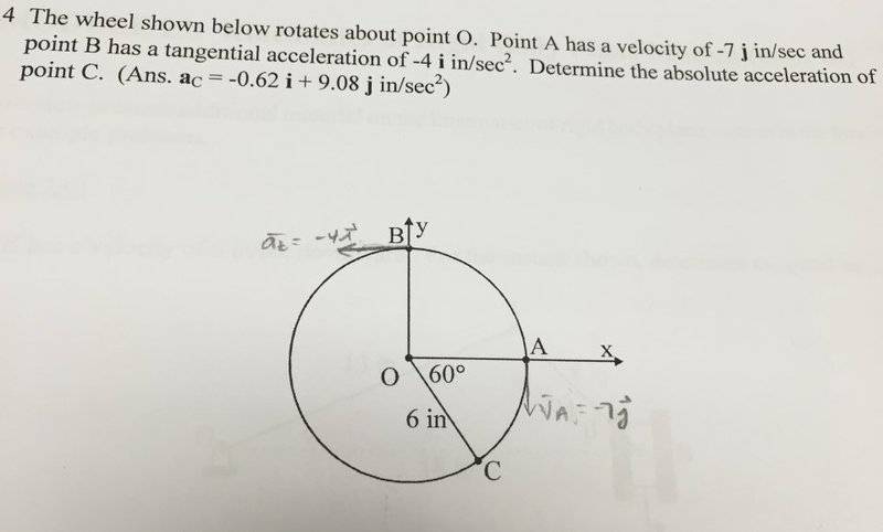

The wheel shown rotates about point O.
Point A has a velocity=-7j in/sec.
Point B has a tangential velocity=-4i in/sec^2
Determine the absolute acceleration of Point C located on the circle.
radius=6 in
You will have to look at the figure for more clarification please.
rA=rB+rA/B
vA=vB+vA/B
aA=aB+aA/B
vA/B=ω×rA/B
aA/B=(aA/B)n+(aA/B)t
(aA/B)n=ω×(ω×rA/B)
(aA/B)t=α×rA/B
I tried finding the velocity of C relative to A. I feel like there is an easy way to find the angular acceleration and angular velocity of the wheel but I don't really know how. Thanks for your help.
The wheel is considered to be a rigid body rotating about a fixed axis. How does the absolute speed of point C compare to the absolute speed of A? How does the magnitude of the absolute tangential acceleration of C compare to that of B?

OK. But more specifically, can you express the tangential acceleration vector of point C in terms of the unit vectors ##\hat{i}## and ##\hat{j}##?
No I can't. Isn't that what the problem is asking?
No, there's more to the problem than just doing that. Does point C have any other component of acceleration besides tangential?
Yes it has a normal acceleration toward the center of the circle. I guess the tangential acceleration would be atcos60° i and atsin60° j
You need to draw the tangential and normal acceleration vectors for point C on your diagram. The tangential acceleration of C is not vertically upward (i.e., not +j) and it's not "to the right" (i.e., not i).
Don't worry about the "hats". You could use bold type instead.

That's getting close. But you need to check if 60o is correct here.
yes it is correct
Did you actually draw the tangential acceleration vector at C on your diagram? What angle does it make to the horizontal?
Yes I drew it. I'm not sure how to tell the angle though...
You'll need to use a little geometry.

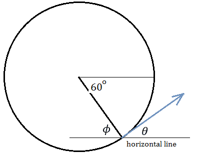

Look at the figure below. What is the angle ##\phi##? Form ##\phi## do you see how to get ##\theta##?
TSny said:
Did you work it out, or is that a guess?
Yes theta would equal 30 degrees
Good. Repeat for the normal acceleration.
normal acceleration would be ancos60°-i and ansin60°+j
