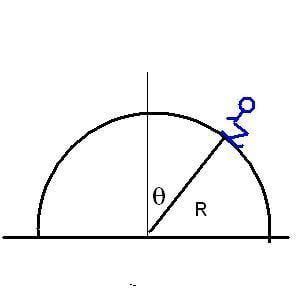

A skier starts skiing from the very top of a frictionless sphere of ice with very little initial speed. At what angle from the the vertical will the skier leave the sphere of ice?
This question was in the Kinetic and Potential Energy chapter, so I guess we are suppose to use the kinetic and potential energy equations K = (1/2)*m*v^2, U = m*g*y and E = K + U.
I can't even attempt this because I don't know how to relate the two energies in a way that would give me the answer.
This question is so much more different than any other question in the chapter.
Apply conservation of energy. What is the KE at the top? What is the KE and PE on the surface at height h deeper then the top? How is the height related to the angle from the vertical?
What force keeps the skier on the circular track?

F(gravity) = m*g*cosθ
F(centripital) = (m*v^2)/r
(1/2)*m*v^2 = m*g*h, where h = r*cos and v = (2*r*g*cosθ)^(1/2)
But when I make Fg = Fc, I get 2*g*cosθ = g*cosθ which comes to 2 = 1.

You made a mistake in the equation for conservation of energy.
The energy at the top of the hill is equal to the energy at the point where the skier detaches from the hill.
What is the potential energy at the top? What is it at the point of detach?

My book says K1 + U1(gravity) = K2 + U2(gravity) where 1 means initial and 2 means final. In this situation I have K1 = 0 and U2(gravity) = 0, so doesn't U1 = K2?
You said that U=mgh, and h= Rcosθ. Is it zero at the final position?KE is equal to the potential difference between the initial and final positions.

I think y*m*g = y2*m*g + (1/2)*m*v2^2

Your mistake is here: h = r*cosθ
What you're trying to do is ΔKE = mgΔh, but you must correctly express Δh in terms of r and θ. Then you'll be fine.
Thanks, I get it now.
