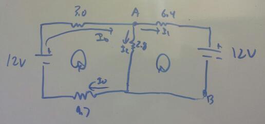

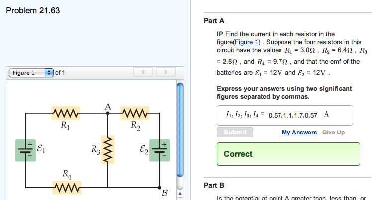

Find The current through each of the resistors (see graphics)
V=IR
I would like for someone to please check my work to see if I have set it up correctly. No need to check actual values. Thank you!

I was going to but I'm afraid I was put off by your hand writing. It's almost as bad as mine :-)
