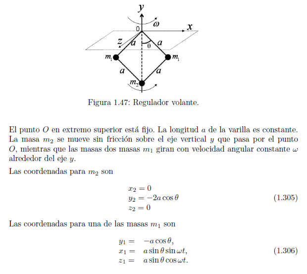

It's not so clear to me, what exactly you want to describe. Are the three masses connected with four (massless?) rigid rods and fixed to rotate around the drawn vertical line? If so, you only need to describe the motion of the two masses ##m## parametrizing their location with the rotation angle ##\phi## around the vertical axis. In this case the EoM will of course tell you that ##\omega=\text{const}## due to the conservation of the angular momentum component in direction of the vertical axis.

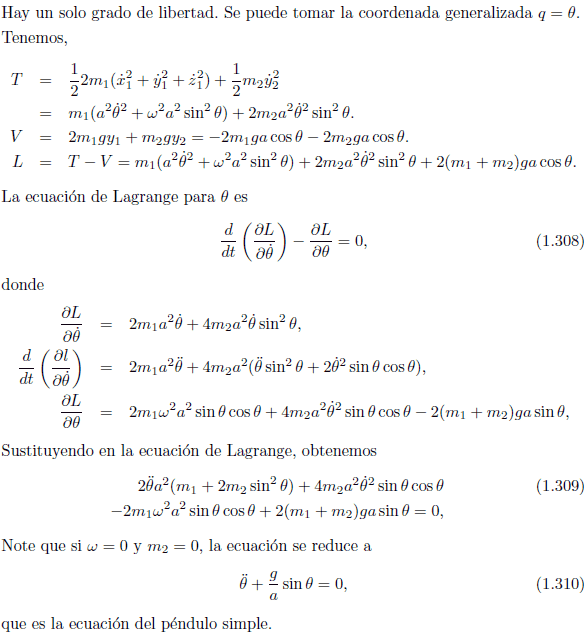

Yes, as you describe, the masses are connected with four massless rods and the system rotates around the z axis. I've already solved it supposing ω=const, but now I have to take out the constraint that implies ω=const. So, the rotational motion this way results not constant?

I solved it as shown supposing ω=const as a holonomic constraint, or restriction. Now I have to take out this constraint, so, the rotational motion will become not constant and the lagrangian changes, isn't it?

Now I understand (the formula density is high enough ;-)). The mass, ##m_2##, is additionally free to glide along the ##y## axis, and you enforce the entire construction to spin with constant angular velocity around the ##y## axis.
If you want to have a non-constant ##\omega## then you can just write ##\phi(t)## instead of ##\omega t## in (3.106), with a given function ##\phi(t)##. That'll be not so easy to solve though (depending on the function you have).

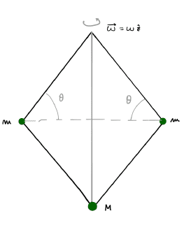

You'll need to pick ##b## as your generalized coordinate (see image below) and get your Lagrangian.
You should get kinetic energy terms like ##m_1 \dot b^2## and ##m_1 b^2 \omega^2##...
Once you get the Lagrangian you'll see at first glance whether momentum is conserved in the x-direction or not.
