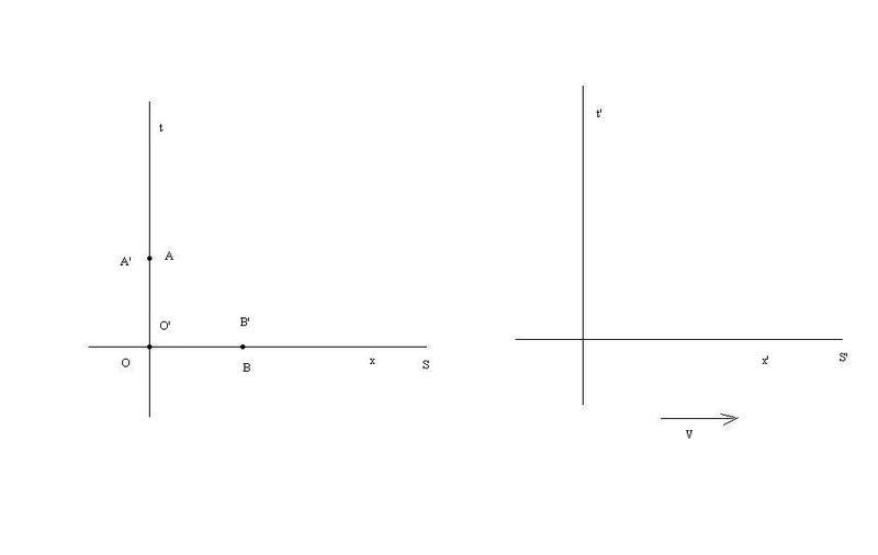

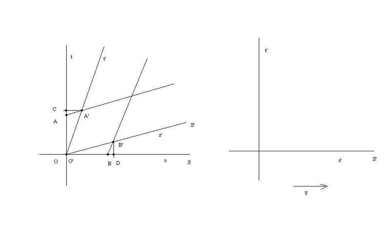

Ok, I accept it that we have to pick two different time components in rest frame to find same time component in moving frame, and with this we can get now length contraction.
Now, please take a look in below image.
This is same as displayed in the link http://en.wikipedia.org/wiki/Length_contraction#Geometrical_representation.
We can say that OA' is length between two events at rest in S'. When we transform O and A', we get O and A in S frame. We can easily say that OA' > OA. So for moving frame S, the length is contracted.
Now, take two events happened at rest in S' frame at O and B' time. When we transform the two events, we get O and B in S frame. We can again easily say that OB' > OB. So, we have to say that time elapsed between two events in S' frame is more than S frame. So time is running faster in moving frame than rest frame.

I have a problem for you to solve using the Lorentz Transformation. Consider two inertial frames of reference S and S', with S' moving to the right relative to S at a speed of v. There is an object at rest in the S' frame of reference, with its left end situated at x'=-Δx', and its right end situated at x'=+Δx'. The origin of the S' coordinate grid x'=0 coincides with the origin of the S coordinate grid x=0 when t'=t=0. At t=0 throughout the S frame of reference, what are the left end and right end coordinates of the object as reckoned using the coordinate grid in the S reference frame (i.e., the x coordinates of the left- and right end of the object)? If there were clocks present within the S' frame of reference at the two ends of the object, what values of t' would observers in the S frame of reference see displayed on these clocks when their own clocks all display t = 0? (Of course, express the results algebraically). What is your physical interpretation of these readings on the S' clocks?
  • #39
But they're not the same. Your diagram has the S system aligned with the horizontal and vertical axes of the graph while the wiki diagram rotates the S system away from these axes so that it presents a symmetrical viewpoint for each frame:
Thus, the wiki text points out that the Proper Length OB at rest in S' is contracted to OA in S. Similarly, you point out in your diagram:
However, the wiki text goes on to say the symmetrical situation also applies--the Proper Length OD at rest in S is contracted to OC in S'. If you do a similar process on your diagram, you will show that the "contracted" length looks longer. This is because you haven't provide markings on your graph to show the numerical values for the coordinates. The wiki diagram gets away with not having to do this because the two frames are symmetrical and the coordinates have equal values.
Time on a spacetime diagram is like the time shown on a clock--the shorter the length on the diagram, the less time is on the clock. So when you say that OB' > OB, you're saying that a clock at rest in a frame accumulates more time than one moving in that frame, correct?

Can we not say t' and t'1 is world lines of the two points O and A in S' frame? And please explain me how to measure distance between two world lines.

I know you know this already yet I have to tell you this.
The both diagram is same. In my diagram whole situation looked from S frame where in your diagram the both frame shown moving relative to each other from a point which is guessed at rest.
OB' > OB. OB' is time elapsed in S' frame between two events at rest in S' frame. OB is time elapsed in S frame between two events at rest in S' frame.
Suppose, OB=1 and OB'=1.25, so there is more time elapsed in S' frame rather than S frame.
Does this not seems that in S frame time running faster than S' frame between two events which is at rest in S' frame?

You don't know what I know. I know that you don't understand Minkowski diagrams at all and it is very difficult to help you when you won't admit your ignorance in this area. For example, you are making a big mistake when think that transforming event A' gives you event A or B' give you B. You really should read the wikipedia article on them. But I would suggest that you forget about Minkowski diagrams and just use the mathematical Lorentz Transformation as Chet suggested in post #37.
Since you are so sure that they are the same, then I challenge you to extend your drawing in the same way the wiki drawing is extended to show a rod at rest in the S frame and how it is contracted when moving in the S' frame.
mananvpanchal said:
A clock that has accumulated 1 unit of time on it in the same time that another clock has accumulated 1.25 units of time is running slower.
But before you spend any more time on this last issue, please respond to my challenge. Or if you prefer, drop the Minkowski diagrams and use numbers with the Lorentz Transformation.
The rod is at rest in S' frame not in S frame in both diagram. So, please, re-explain me your challenge.
Yes, we will take a look on this later.

Your diagram has a rod at rest in the S' frame just like the diagram in the wiki article. But the wiki article has a second rod at rest in the S frame:
The Lorentz transformation geometrically corresponds to a rotation in four-dimensional spacetime, and it can be illustrated by a Minkowski diagram: If a rod at rest in S' is given, then its endpoints are located upon the ct' axis and the axis parallel to it. In this frame the simultaneous (parallel to the axis of x') positions of the endpoints are O and B, thus the proper length is given by OB. But in S the simultaneous (parallel to the axis of x) positions are O and A, thus the contracted length is given by OA. On the other hand, if another rod is at rest in S, then its endpoints are located upon the ct axis and the axis parallel to it. In this frame the simultaneous (parallel to the axis of x) positions of the endpoints are O and D, thus the proper length is given by OD. But in S' the simultaneous (parallel to the axis of x') positions are O and C, thus the contracted length is given by OC.
I'm asking you to show on your same diagram, a second rod at rest in your S frame and then use an identical process that you used for your first rod to show that this second rod is contracted in your S' frame.

Suppose, in S frame there are O is origin, A is on t axis and B is on x axis. Now If I transform the two points I get A' and B' in S' frame. Now OA < OA' and OB < OB'. Now, please you guys interpret your way the time dilation and length contraction. I don't know how to interpret this. I am eagerly waiting to hear the interpretation from starting of the thread. I know this is the place where I am stuck. Please, interpret it for me. Thanks.
  • #52
ghwellsjr said:
You're never going to understand either length contraction or time dilation using Minkowski diagrams until you realize that you are not doing them correctly. If you will attempt to do what I have asked, it may become obvious to you that you don't understand them. Chet also gave you a challenge which you also ignored. We're trying to help you but if you refuse to cooperate, no progress will be made.
Your challenge is about to length contraction and I have already told that I am agree on this. So I am agree then what do I do after taking the challenge. Your challenge should be about to time dilation. And I cannot get fully chat's challenge so I have requested them to give me detail already. Where am I not co-operating?
  • #53
You've picked two events A and B with x,t coordinates A(0,t) and B(x,0). Is that what you really want?
When you transform to the S' frame you get the same events A and B just with different coordinates. But in your diagrams you are creating new and different events A' and B'. Don't do that!
So what?
The events OA can represent a time measurement made on a clock in S, so of course Δt' > Δt. That's time dilation. Moving clocks run slow.
The events OB are simultaneous in S, so of course Δx' > Δx. That's length contraction. (Note that the events are not simultaneous in S', which I think is where your problem lies.)
Where's the problem?
