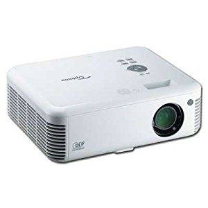

matiasmorant said:
Drakkith: the barrels were made of bright steel
A.T.: there where multiple lights around, there was a projector, light bulbs, light of cars driving by the street... i would say the reflection in the beer barrels wasbeing produced by the light bulbs
It was the projector. I observed the same thing today. Look at the lens from the side, so it doesn't blind you. Then perform some rapid eye movement. In my case it was this model:
