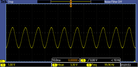

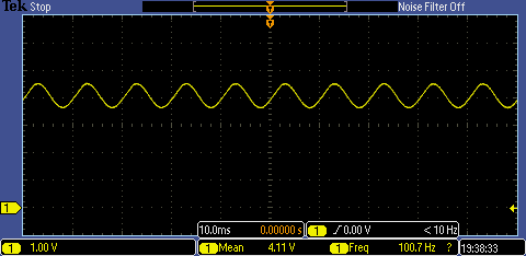

Here a graph of the light output for a 9.5W Cree
and
And one for a 60W incandescent
That's at (edit) 50hz100 hz, twice power line frequency where he lives. In US it'd b 120hz. Whatever is a "Cree" it looks to have more powerline frequency flicker than incandescent.

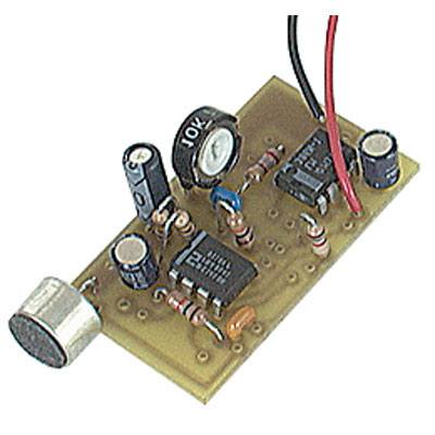

Seems one could adapt a "Super Snooper" amplifier to use a photosensor instead of microphone...
http://www.jameco.com/webapp/wcs/stores/servlet/Product_10001_10001_151204_-1
I'm obsolete, but today's experimenters would probably grab an Arduino or PC instead.
I have and Arduino and just starting to experiment with making it do stuff. I was kinda hoping for someone to point me to a ready made circuit I could build to shave a month or two of experimenting on my own but that is how you learn. In the mean time I bought a couple of off the shelf LED light bulbs to disassemble and see how they tick. I already made a light that uses DC to supply the LED and installed it in her living room to see if that helps .. it is ugly but functional as an experiment.

ahhhh electronics experimenters get accustomed to power supply hum and recognize it.
They were looking for power line frequency. That's the mechanism that makes them flicker
Here's a current trace from Wikipedia
https://en.wikipedia.org/wiki/Compact_fluorescent_lamp
What do you suppose the voltage across the lamp's filter capacitor looks like?
Clearly when conduction begins it is less than line voltage
and presumably it charges to power line's peak value because conduction continues until peak
so I'm estimating from above picture that the filter capacitor delivers to the lamp's internal high frequency oscillator
a voltage that swings from 74% to 100% of incoming power peak,
in US that'd be maybe from 130 volts to 175 volts with a sawtooth shape.
Like this only it sags clear down to 75% between peaks
http://upload.wikimedia.org/wikipedia/en/thumb/7/7e/Smoothed_ripple.svg/400px-Smoothed_ripple.svg.png
so the high frequency oscillator because of its varying input voltage does not deliver constant power to the lamp's phosphors
and light output follows , at twice line frequency.
You probably knew that already.
my point was - i think line frequency is your culprit
probably the light, but maybe audio noise for the current is a series of high frequency bursts repeating at 120 hz
That light sensor from candlepower forum is good into mid audio range , a few khz
and peak sensitivity is down in the red (700 nm)
(hardly ideal for quantifying flourescent light)
so It probably under-reported variation in their LED and over-reported for the incandescent

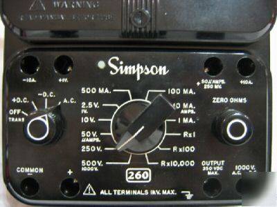

dmac257 said:
If I made or bought a DC power source I would have no way to MEASURE the DC ripple
Most DMM's when selected to AC will only report the ripple
most inexpensive analog meters won't do that trick
but
a good quality analog meter like Simpson 260 has a jack labelled OUTPUT, lower right
it connects to an internal capacitor in series with the meter
to block DC
so that you can use it in set for AC to measure power supply ripple.
holy smoke, I haven't see a Simpson 260 in almost 30 years. do they still make them??
dmac257
Yes but they are high.
I still have the Triplett 630 i bought new in 1964
and a Simpson 260 i stumbled across in a pawn shop...
they do show up on Ebay
