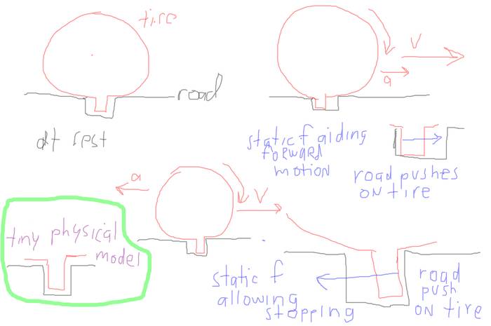

Thanks.
The friction part is my bad habit of trying to model things too simply. If I might draw a picture of a tire of how static friction might start and stop a car maybe you could elaborate on it? I don't wish to hijack the original question. Just trying to understand.
Comments?
pgardn said:
Comments?
Your 'peg in hole' model could perhaps be improved by making the cross section a V shape in a V shaped slot (many of them side by side). The relationship between weight force and the lateral force to balance it, would be Tan(slope angle) and that would represent the coeff of friction (∞ for vertical sides). If the lateral force exceeds this, the V will slide up out of the slot and you would have slipping. The nice thing about that simple model is that it follows the law of friction and gives a constant value of μ for all loads.
The force is always against the desired displacement, which provides a braking or driving force, as required. Sometimes you can sort this thing out in your head by drawing diagrams (like above) of all different situations and 'believing' that the forces are in the right direction - then fitting your in-brain model to that. (The conceptual leap is never half way. It's one way or the other)
Actually the model (teeth being triangles) is the model I use to provide for static and kinetic friction.
But here is where I run into problems with that model:
If a ball rolls up a rough surface while slipping and slowing down I see the static frictional force acting up the hill and the kinetic friction acting down? And this confuses me. Like the triangular teeth slip back (the surface of the tooth parallel to the plane of the hill) and then the part of the tooth that is perpendicular to the plane of the surface then acts to keep it from slipping further providing a static frictional force up? Can you make sense of this?
Thanks for your help.

So my physical model which allows for both static and kinetic friction is wrong. This is the problem I have. I have a model which makes physical sense to me. Now what I would normally try to do is fit the model in with the tire changing shape, the ground beneath actually changing composition, etc... (I can also see there might also be a bit of adhesion on the molecular level thinking about dragsters spinning their tires to make a sticky surface)
But I won't.
Thanks for your time.
My view is that the tyre is either static with respect to the ground or it's moving. If you just take a block and try to pull it along, you have static friction until it breaks away and then, once it is free, you have kinetic friction (often less). As the speed increases, there can be other losses, due to deformation of block and ground. With a driven wheel, you are mostly dealing with simple static friction Until it slips - when it's kinetic. If the wheel is slipping, how can you say that there is a static condition?
If your model makes physical sense to you then you should try to test it for credibility. Is it really consistent with experience?
ABS braking improves the retardation by ensuring that no wheel goes faster than the others (showing it is slipping.) The static friction force is greater than the force after is slips. That applies on your sloping situation.
When dragsters melt their tyres the situation is non-linear and there is no simple model to describe the phenomenon.
It makes physical sense with the triangular teeth model. The diagonal teeth can slip and at the same time can catch.
Again if you model the vertical component of the teeth you get some static friction (which really is a lot like a normal force like in the peg picture I drew. It's possible the peg like tooth could just sheer after exerting a static force. Like if one puts a more massive load on plane of wood till it breaks. Even when something slips this could still exist with the model I already presented using diagonal teeth.The horizontal component of the tooth would allow for the classic slip. I can see different parts of a larger body slipping while others remain static.
Now I may to read more about shearing, compression etc... as I may have ideas about this that are horribly wrong.
But if my simplified model does not fit experiment and observation then it's no good. It's much simpler actually to use your idea of you are static or you are not.
PS
I realize I am not very good at expressing my ideas with English. I'm much better with a face to face sit down while drawing pictures. I tend to think visually before mathematically. So sorry for this.
  • #31
If they are slipping and catching at the same time, it would imply that the angles were not uniform. Fair enough but then there would be fewer teeth that were actually catching which would imply less net friction force. We are reaching a familiar stage in this discussion where the questioner seems more determined to make their personal view work than to accept where there are flaws.
Your suggestion that you could have vertical movement of the V teeth without horizontal movement is ignoring the fact that there is a slope. Your model also would have to include a flexible structure if different things happen in different places.
But how can you call one of your forces 'static' if there is movement?
Have you read about this stuff recently? Why not look at the wiki article and then widen your reading with the reading list or just a determined google search? Q and A is not a good way to get a general education about a topic.

Not at all. It's just that we all try to hang onto ideas that we have come to love. You are right to resist a change of view without reasonable cause. A conservative approach is needed or Science would be doing Brownian motion all the time. :smile:
Your English is pretty good, aamof. You were getting your ideas across well enough.
