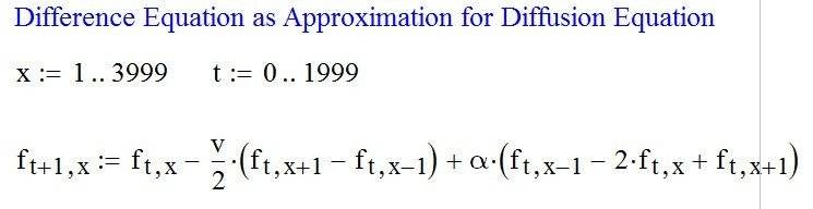

The following is what I have achieved so far. I would really appreciate any input from you! Thank you very much!
Δt := 1 min
Δx := 5 m
v := 16.09 km/h
D := 0.17*10^-4 m^2/min
t := 0 ... 1999
x := 1 ... 3999
f_t,x := 1
f_t+1,x := f_t,x - (v*Δt/2)*(f_t,x+1 - f_t,x-1) + [D*Δt/(Δx)^2]*(f_t,x-1 - 2*f_t,x
+ f_t,x+1)
Then it crashed! Can anyone help me, please?

It looks like you're trying to evaluate 8 million array items. It your machine has enough memory, it probably didn't crash but rather the mathcad application has gone catatonic while it grinds away at the numbers (for each t value it's evaluating 4000 x's).
Reduce your t and x ranges to something trivial for testing purposes and check to see if what its doing is really what you expect it to be doing.

First, your term (v*Δt/2) is going to have units of meters, while the rest of the terms would appear to be unit-less. This is going to result in a units mismatch error. Perhaps this rendering of the program is not correct?
You are also pre-filling the entire f array with 1's, then you proceed to overwrite them all but the first one, f_0,1. Any particular reason for performing all the extra work?
You are using an index of x-1. Since x is defined to go from 1..3999, it will reference f_0.0 which does not exist. You will have to set a starting value there.
When you say that MathCAD crashed, do you mean it locked up (became unresponsive or disappeared altogether), or you you mean that one or more expressions are reporting errors?

Hi qneill,
You made really good comments!
This programming is part of a bigger question. The question wants me to simulate the dipersion of airborne pollutants. More specifically, I have to model numerically the time dependent spatial dispersion of the one-dimensional probability density f(t,x). v is the velocity in x direction of the wind that carries the polluting gas, D is the difussion coefficient. The program requires that, for any given time t, f_x is calculated for all distances x. Then t is increased by D_t, and again f_x is calculated for all distances x, and so on.
f(t=0,x=x_0) = 1 is the initial condition. You're right! I'm also very confused about this initial condition. I think it should be f_t,x-1 = 1, right? But if you look at the attachment, which was copied directly from my Professors's solution which he gave me as a hint, he put f_t,x. May be I misunderstood or misidentified the initial point. That's why I'm very confused!
I noticed the unit inconsistence. But first, I want to follow my Professor's hint (the attachment), then I will go back and take care of the units later. The attached equation is the numerical version of the diffusion equation ( or Fokker-Planck equation).
I think we arrive at the same point of confusion now! Yes, I was also wondering how to define the end points. I think in order to limit the array, all the end points must be defined. Neither the question nor my Professor's hint mentioned about the conditions of the end points, except the initial condition f(t=0,x=x_0) = 1. I think they are implied in the question, but I just can not get it! If I can successfully define the end points, I think I can solve the rest of the question.
When I said "crash", I meant the expression was highlighted in red, i.e. the x+1 or the t+1 indices was highlighted in red. I'm so confused that I don't know which ones I miss and which ones are incorrect.
If you would like more information, I would be happy to give you more. I was just afraid that my post will be deleted if I post the whole question.

Suppose you define your index variables as:
nt := 2000
nx := 4000
t := 0 .. nt - 1
x = 1 .. nx - 1
Your difference equation references f_t+1,x on the LHS, while on the RHS it needs values for f_t,x , f_t,x-1 , f_t,x+1 . This means that it is looking for values calculated at the previous timestep, t = 0, when it's assigning values to f_t+1,__. That's fine.
Now check the x indexes. On the LHS they range from 1 though 3999. On the right they want to go from 0 (for f_t,x-1) through 4000 (for f_t,x+1) at the ends of the range. That means you're going to need to pre-assign values for x=0 and x=4000 for all of t.
Presumably, since you mention that this is a diffusion problem, these pre-assigned values will represent the boundary values for the diffusion field.
I would suggest, then, setting up the entire first row of your f_0,x with the initial concentration pattern, and then setting:
Cb = {some value representing the concentration at the boundaries (could be zero)}
f_t,0 = Cb
f_t,nx = Cb
and then proceed with the diffusion calculations.
You're going to have to work out the issues with the weighting term v*Dt/2. I don't think it should have units or be greater than 1.0, otherwise the numbers are bound to 'blow up'.
[edit] On second thought, just preset the entire f array to zero (including the boundary elements at x=0 and x=nx), then plug in your initial concentration starting condition on the t=0 row.
haitrungdo82: Because you only use the immediately-preceding row of matrix f, then only the immediately-preceding row must preexist, as follows. I numbered the lines, for easy reference.
(1) nt := 2000
(2) nx := 4000
(3) t := 0 ... nt - 1
(4) x := 1 ... nx - 1
(5) f_0,nx := 0
(6) f_0,1 := 1
(7) f_t+1,x := f_t,x - (0.5*v*deltat/deltax)*(f_t,x+1 - f_t,x-1) + (D*deltat/deltax^2)*(f_t,x-1 - 2*f_t,x + f_t,x+1)
Notice, line 5 is the only line you were missing, the absence of which caused the j = 4000 column in matrix f to not exist. Line 6 sets the initial condition, presumably according to your professor (?).

haitrungdo82: My thinking was very vague. We know 0.5*(f_t,x+1 - f_t,x-1)/deltax is the first-order finite difference approximation of the first derivative, if I recall correctly. And v*deltat is an x (horizontal) distance. Therefore, this horizontal distance times the above-mentioned first derivative (which would be the tangent of the slope angle) should be a vertical (y) distance, if I recall correctly.
We know (f_t,x-1 - 2*f_t,x + f_t,x+1)/deltax^2 is the first-order finite central difference approximation of the second derivative (curvature), if I recall correctly. Therefore, similarly, when we multiply this value times D*deltat, we get another y distance. I do not recall the exact details.
Therefore, I vaguely envisioned that if we supply a D value too large or too small, the equation was overshooting below y = 0, or overshooting in the horizontal direction (?), which, in either case, would give garbage. I envisioned that if D is too small, it has no effect on the dispersion. If D is too large, the equation overshoots. I envisioned if deltax is too small, we get almost a singularity, called overflow. We want to increase D, but I envisioned that we cannot increase it too much unless we decrease deltat; otherwise, the problem will overshoot, as explained above. I envisioned that you cannot decrease deltat below a certain value, or else the problem will crash or overshoot. And I envisioned that you cannot decrease deltax below a certain value, or else the problem will crash or overshoot. E.g., if we want to simulate out to 10 km, it seems deltat cannot be less than 0.5 s, and deltax cannot be less than ~8 m. I do not understand very well what was going on, nor how to control the diffusion equation. If you uncover anything else, feel free to let us know.
I had to increase D seemingly too much (?); but that is the only way I could get the problem to run. In your given problem, D is overpowered by the relatively high wind velocity.
In the "Graph from Question" file, we see a lot of diffusion, and almost no wind. We can see that the centerline of the probability density moves slightly in the negative x direction, which means there is a very, very slight wind in the negative x direction.
By the way, to reply to a post, did you know you can just press the "New Reply" button? You don't need to press the "Quote" button on every reply. Also, always leave a space between a numeric value and its following unit symbol. E.g., 10 km, not 10km. See the international standard for writing units[/color] (ISO 31-0[/color]).
