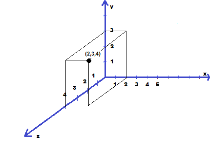

Have you tried to visualize this case? One possibility is to us a coordinate system like this one:
E.g. if you have a plane and a straight, then the question is, whether we can find three linear independent vectors, two in the plane, one for the straight, which are not necessarily orthogonal anymore. As all are expected to be subspaces, they all have the origin in common, which rules out that the straight and the plane can be in parallel. So the only question is, whether the plane contains the straight or not. Similar considerations can be made for two planes or two straights. I recommend to draw your examples, to see how the algebraic and the geometric descriptions relate to each other.
