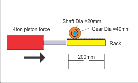

Physics answer: Torque is force times radius, so 4 tons X 20 mm. Then you need to put that into usable units, such as foot-lbs or Newton-meters. Be sure to use the gear pitch diameter, not the outside diameter.
More realistic answer: 4 tons will shear off the teeth of any normal 40 mm diameter gear, so zero torque.
Thank you for your reply.
Actually the gear and rack is hardened Hadox material and it is currently working in a machine. This gear can take up to 10 ton pressure (;-)
So what is the actual answer in Newtons?
Undefined. Torque is not measured in Newtons.
4 tons of force is about 35000 Newtons.
20 mm of radius is 0.02 meters.
Multiply them together and you have 35000 ##\times## 0.02 = 700 Newton-meters.

Ok, apologies. However, the problem is does the torque not vary with the input linear speed? The 35,000 Newtons are moving at 200mm per minute. What happens if it moves say 200mm per 20 seconds?
No. Torque does not vary with input linear speed.
The power delivered by the torque does vary proportionally to input linear speed. You could compute that based on linear speed times linear force. Or as angular velocity times torque.
For force in Newtons and velocity in meters per second, the resulting power in Watts is simply force times [parallel] velocity.
For torque in Newton-meters and angular velocity in radians per second, the resulting power in Watts is simply torque times [aligned] angular velocity.
