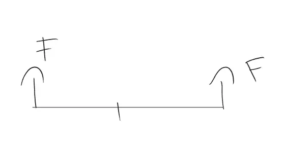

Hi, I have the following question:
Suppose you have an ideal rod and two forces of equal magnitude are applied to its ends, in such a way:
Now it is obvious that the rod is in rotational equilibrium but my textbook says that for rotational equilibrium, the net torque must be 0 about any axis, however in this case it is only 0 about its midpoint. So what am I missing here?

The downward force of magnitude 2F that is applied at the midpoint pivot.

You simply define 'rotational equilibrium' differently than your textbook.
It's true that your rod, if initially at rest, will not change its orientation, and thus will not start rotating in a reference point invariant way.
But for reference points, for which the net torque is not zero, it will gain angular momentum. To prevent this, the net force must be zero as well.

Thanks, but I'm curious about this specific case where there are only these two forces. I can see that in the situation you're talking about, there's clearly torque equilibrium.

Thanks for your answer! Does this imply that it is impossible to achieve rotational equilibrium (not just about certain point(s) but for a body) without the net force acting on the body being zero?

If there are only those two forces then there is a non-zero net linear force. That means that there is a non-zero rate of linear momentum change. (##\sum F = ma = \frac{dp}{dt}##).
That, in turn, means that if we take our rotational axis somewhere other than on the line traversed by the center of mass that the non-zero rate of change of linear momentum results in a non-zero rate of change of angular momentum. ##L = r \times p + I \omega## and ##\frac{dL}{dt} = r \times \frac{dp}{dt} + I \frac{d \omega}{dt}##. If the displacement (##r##) of the center of mass from the reference axis is non-zero, this matters.
One can have a non-zero net torque without an associated non-zero rotational acceleration.
Based on the definition your book apparently uses, yes. Because of what @jbriggs444 wrote above.

My guess is that what you are missing is that you are not mentioning what is likely stated in the texbook. Is there really no mention in the textbook of the support force at the center of the rod? That force, by the way, is pushing upward on the rod.
If indeed the texbook makes no mention of the rod being supported at its center, then you are indeed correct and you are missing the nothing. The texbook, on the other hand, is missing the very important reference to the support force at the center of the rod. Without that support force the net torque on the rod is not not zero about every point, and you are very clever for realizing that.
The oft-mentioned notion that if something is in rotational equilibrium about one point, then the net torque about every point is zero, depends on the object also being in translational equilibrium.
