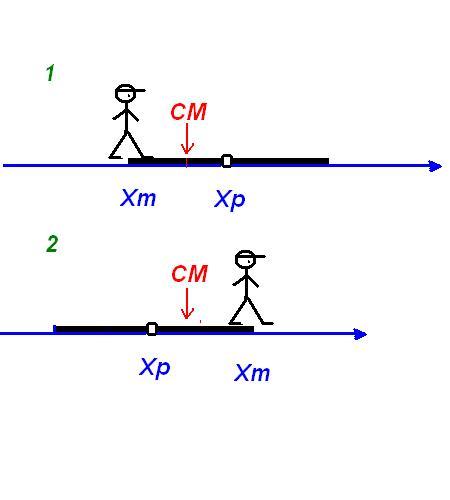

3. A person of mass 50 kg is standing at the end of a plank of mass 100 kg and length 5m and the plank rests on a horizontal smooth, icy surface. If the person walks from one end to the other, by how much will the plank move? Why?

3. The plank and man is a closed system, only internal forces acting along the icy surface. What is the quantity conserved when there is no external force?

3) The forces from the man and the plank? mg? I'm not really sure.

As for question 3: The same but opposite forces act between the man and the plank so the net force is zero. What happens with the centre of mass of the plank-man system if there is no external force?

If there is no external force, then velocity is constant and the system does not move?

If it did not move before the man walked from one side of the plank to the other, it will not move as a whole. The centre of mass stays in rest, while the man and the plank move relative to each other and relative to the ice.
See attached picture.
