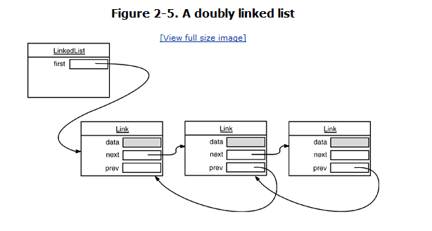

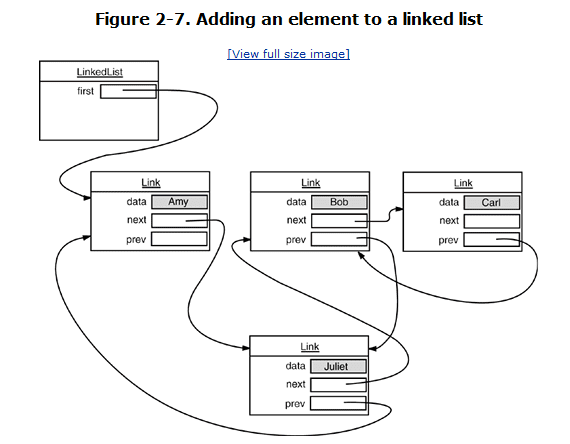

I don't understand the concept of linked list. I mean, I do understand it, but I don't understand how to add something to a linked list. I know there are three diffrent ways to add, one is to the front, the other one is to the back, and the last one is anywhere. But I don't understand howt o do this. Like can I get a sample code?

A linked list is like a chain of paper clips. Each clip storing some value. Each clip knows what clip comes after it. Your program grabs the chain of clips at one end, called the head clip. If you want to insert a clip at the top then you connect the clip on top of the head clip, and make that the new head clip.
If you want to insert at the bottom, then you just connect the clip on the tail end of the chain.
If you want to insert in the middle, say after a specific clip, you start at the head and come down through chain until you find the clip after which you want to insert, disconnect the chain at that point, insert your clip, and then append the rest of the chain after your new clip.

Each different data structure has a specific strength and weakness. That is why there is not a single data structure but we have quite a few different ones and a few different categories of them, namely you have Lists (order of elements matters, can have duplicates), Set (order of elements does not matter, cannot have duplicates), Map (stores ordered pairs (Key, Value), keys are unique, cannot have duplicate keys) and finally Queue (usually you add elements only to the back, and take elements either from the back or the front, generally you have 2 kinds of queues FIFO and LIFO, that would data structures in a nutschell.
What is the purpose of LinkedList?
Notice it is a List, soo you have a "list" of elements where their order matters and you can have duplicate entries(same value at different locations).

For that reason there is LinkedList it enables efficient insertion and removal of elemenets at any location including the front and the middle.
How is that achieved? Using Links. Each element knows which entry is in front of them and which entry is behind them. Soo if you want to add an entry you simply modify the links, the remove you do similar job. Soo there is no array behind the LinkedList that would need to be recreated and copied and stuff almost everytime you add an entry at an arbitrary position. But as any data structure the LinkedList has it drawbacks and that is to access an entry at a particular location let say get(25) will have to traverse all the links before the position to find it. Soo accessing the link at an arbitrary location is not very efficient at the LinkedList. Maybe you can try implementing your own ArrayList for starters and then LinkedList.
I would recommend the Big Java book by Horstmann it has 3 chapters on Data Structures that explain the basics and some more advnaced things of Data Structures.
