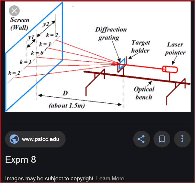

I am trying to make a spectrometer. At the moment, I have an optical setup consisting of a laser, diffraction grating and a screen/detector in a straight line. I am trying to understand how to estimate the location of the diffraction pattern of the slit on the screen? Is it the same location on the screen as the location of the laser/source?

A "diffraction pattern" from a diffraction grating using a laser will consist of more than just one dot on the screen. So how can it even be "the same location on the screen as the location of the laser"? Or are you looking at just the 0th order?
The location of the diffraction dots will follow the standard diffraction equation for diffraction grating.

It depends on your diffraction grating - you can make one to produce more or less any pattern you want. Assuming it's a set of parallel lines, then the pattern is (at least theoretically) infinitely wide. The brightest part, however, should be more or less where the laser would strike the screen if the grating wasn't there.
I am only targetting to capture the first and central spot. I think it should be on the sample plane as the point source.

The diffraction pattern is not imaged onto any particular plane. Varying the distance between screen/CCD array and slit(s) will simply result in the diffraction pattern size changing. The diffraction pattern is more cleanly described in terms of angles, not linear dimensions.
