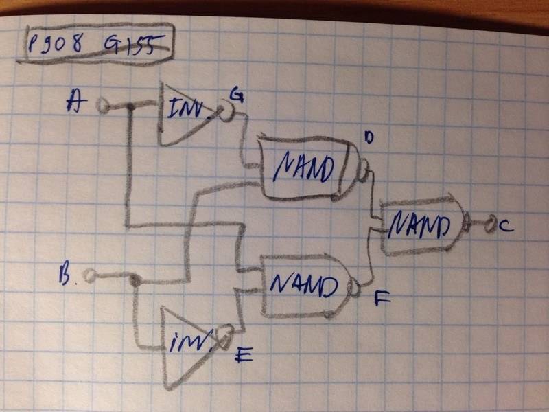

2. The attempt at a solution
Circuit:
A B G D E F C
0 0 1 1 1 1 0
1 1 0 1 0 1 0
0 0 1 1 1 1 0
1 1 0 1 0 1 0Answer:
Is (a) right? And any ideas what could be (b)?
Your A and B columns should show all possible values {00, 01, 10, 11}
The output of the D NAND gate is: A' NAND B = (A' & B)' = D
and the F NAND gate is: A NAND B' = (A & B')'

Your A and B inputs can be any binary value so since you have two inputs you have a possibility of 4 input values to the circuit as shown in the table above.
I get it now.
So:
Code:
A   B   G   D   E   F   C
0   0   1   1   1   1   0
0   1   1   0   0   1   1
1   0   0   1   1   0   1
1   1   0   1   0   1   0
That's what I got too. The circuit diagram has a symmetry about it which is seen in the truth table.

Look at the A and B inputs and then the C output doesn't that look like some gate you're familiar with?
I would say the "final" truth table should include only A, B, and C.
AND has 0001 at output
OR 0111
NOR 1000
NAND 1110
Inverter 10
And I have at output 0110. The input is the same for this circuit and for AND, OR, NOR and NAND.
The truth table for this problem should have three columns - two for A and B inputs, and one for the result C.
