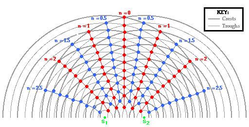

chill bro, I need some time to wrap my head around it.I was thinking of the double-slit experiment.
In this diagram you can see the nodal and anti-nodal lines, the bright and dark fringes of an interference pattern:
The nodal lines are hyperbolas.
If we consider distances far, far away from the sources, the hyperbolas can be approximated as radiating from one specific point.I created a Desmos worksheet to demonstrate a plot of the Intensity against angle:
https://www.desmos.com/calculator/jv5sk0mucx
It follows this formula:
Now consider a circular screen which is extremely large so we can do the radial approximation. We also don't have to worry about the inverse-square law because the circular screen makes all the distances about the same. I assume the energy output is approximated by integrating the intensity across the arc distance of the circular screen.
If you try integrating the formula above from π/2 to 0, you get this:
https://www.wolframalpha.com/input/?i=int+(cos((a*tanx)/sqrt(1+(tanx)^2)))^2+from+0+to+pi/2
Based on my naive assumptions about energy conservation, I assume that energy is transferred from dark fringes to bright fringes.
I thus expect the integral to be simply π/4. Because looking at my Desmos plot, I expect the area under the green curve to be equal to the area under the blue horizontal line if energy is conserved.However, from Wolfram Alpha, the integral is not simply π/4, but has a Bessel function component. This is what I'm confused about.
d represents the slit spacing and W_L represents the wavelength. Apologies for any grammatical errors, I'm quite tired as I'm writing this. Feel free to ask me any questions about the Desmos worksheet.
