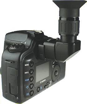

I've also seen that Canon sells a 90 attachment for the viewfinder itself:
It's really not easy to use an optical viewfinder when you really need it in the dark. I'd bet you could afford another camera for the cost of a fancy Canon bolt - on (well, almost)
