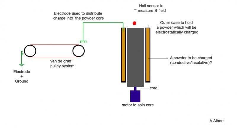

Hi Simon,
You are right that since this is an experiment it would be best to set up proper controls and define a clear aim.
I have attached a sketch of my proposed setup to help with my description of the experiment. Since the amount of charge I can accumulate will be a function of the material's surface area, I think that a powdered material would be best so as to maximize the surface area/volume ratio. Powders are also well known to easily pick up static charges during handling. The powder will be held in the walls of a hollow cylindrical case. The diagram shows the charging apparatus (the belt and pulley system used in a van de graff setup) which induces a charge on an electrode connected to the powder through a hole in the case. It occurred to me as well that as long I was using a solid core material I could achieve the same relative motion by spinning the core rather than the case, which I think may be more stable as vibrations induced by spinning the case may cause some charge loss (I have no idea if its true but it still feels like a cleaner solution). A hall sensor placed at a fixed position above the core will measure the B field.
The aim is to determine the magnetic field induced within a fixed volume by physically moving an electrostatic charge, I will keep the following constant between runs:
- size of the core
- size of the case
- belt and pulley RPM
I will then measure the relationships between the core RPM and induced B field.
I have read, as you mentioned, that insulating materials are better at holding charge, but I'm not sure if I can charge an insulator in the way I described. Could you clarify this for me, as well as give me any opinions you have on my setup and how I may improve it? It seems fairly low cost all in all, as I have a hall sensor already as well as some small motors.
PS: The diagram says 'Electrode used to transfer charge into the powder core' but I shouldn't have used the word core there as it may be a bit confusing. For clarity, the powder is in the cylindrical case, and the core is a piece of soft iron.
  • Sketch of an apparatus: a van de Graaff pulley system with a grounded electrode on the left, a green wire to a hollow cylindrical case holding a powder, a rotating core driven by a motor below, and a Hall sensor above the core.
Insulators are easily charged - i.e. amber and glass can be charged by rubbing.
Just a note - is rotating an iron rod by a charge the same as rotating the charge about the iron rod?
How does this symmetry work in electromagnetism?
