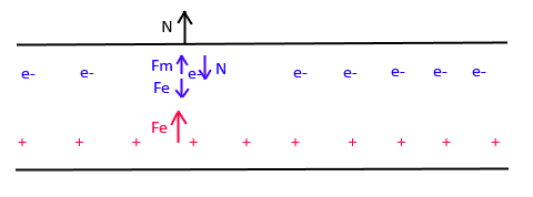

Thanks you everybody! @Delta2, I read your post, very helpful! So, let's see if I understood it properly. Consider the image below of a wire conducting a current. There is a voltage difference V in the wire so that the current is to the right and there is also a magnetic field pointing into the paper:
As the wire is a conductor, there are a lot of free electrons in it. These electrons move freely, so I will consider them to be a separate body. The electrons are the only charges who are actually moving, so only on them there is a magnetic force upwards ##Fm=qvB##. The Hall effect will make the electrons go up and a positive vacancy be created in the bottom. As the positive vacancy is not moving, and is not free, there is no magnetic force being made on it, and we will also consider it to be part of the wire body. The Hall force created is equal to ##Fe##. By the equilibrium of forces in the electron (considering electron mass is almost zero) ##N=Fm-Fe##, so the net force in the wire body is ##N+Fe=Fm##. Until now, did I understand everything properly?
Ok, now my real problem is when I try to see who is doing work. I understand that, if we consider the above forces to be the only forces acting in the wire, there will be an acceleration upwards and a net work being done. By what I think I understood, the force doing the work is N? What is the nature of that force?
Also, when the electrons move upwards due to Hall effect, it seems to be a work being done on them (in this case by the magnetic force that is upwards and the trajectories that seem to be upwards too), I can think of an explanation where the electrons move in a circular path as when we study a single charged particle in a magnetic field, and the work is zero because the magnetic force is acting as centripetal (is it true?).
What when the electrons get to their final vertical position relative to the wire, in the top of it, and the wire starts to accelerate upwards because of N? The electrons will also accelerate upwards. Will the magnetic force on the electrons continue to act as centripetal? How? In that case, what will be the trajectory of the wire (will it accelerate upwards in a straight line or will the wire starts to rotate)?
I'm asking this because the velocity of the electrons in the vertical plane will be much higher than the drift velocity in the horizontal plane. So there will be another "Hall effect" on the electrons where magnetic field will produce a force to thhe right. If the wire accelerate upwards in a straight line this effect will effectively reduce V. We could calculate the force acting on the electrons because of V. This would be ##Ve/d## where d in the length of the wire. The magnetic force acting on the electrons when they are accelerating upwards is evB. If we consider V=1V, d=10m, B=0,01T and v=10m/s (I think these values can happen in real life) we would zero net force effectively stopping the current. Is this true?
As the wire is a conductor, there are a lot of free electrons in it. These electrons move freely, so I will consider them to be a separate body. The electrons are the only charges who are actually moving, so only on them there is a magnetic force upwards ##Fm=qvB##. The Hall effect will make the electrons go up and a positive vacancy be created in the bottom. As the positive vacancy is not moving, and is not free, there is no magnetic force being made on it, and we will also consider it to be part of the wire body. The Hall force created is equal to ##Fe##. By the equilibrium of forces in the electron (considering electron mass is almost zero) ##N=Fm-Fe##, so the net force in the wire body is ##N+Fe=Fm##.Until now, did I understand everything properly?
Unfortunately you still have some vital misunderstanding. (Your figure is not exactly correct, I wish I could do my own figure to show you exactly what I mean, but I am not good in using drawing programs, so I ll just have to use words to explain you the whole thing).
First all in my analysis I took that the wire doesn't move as a rigid body (otherwise there would be motional EMF, besides the Hall voltage and that would complicate things).
Now, the hall voltage has an associated electric field ##E_{Hall}##. The sources of this field are the surface charges that are located in the upper and lower side of the conducting wire (if I could do a figure I would draw ----- minus charges in the upper portion of wire and ++++ charges in the lower portion of wire (as you did) and with the free electrons being in the middle). These surface charges are "created " during the mini-transient state during which the Lorentz force ##e(\vec{v_{drift}}\times \vec{B})## is unbalanced by the electric force ##eE_{Hall}##. But soon we reach equilibrium and we ll have ##e\vec{E_{hall}}=e(\vec{v_{drift}}\times \vec{B})##. So in a free electron and once the equilibrium has being reached,we ll have those two forces (the electric force due to ##E_{Hall}## and the magnetic Lorentz force) that are equal and opposite in direction. So ##e E_{Hall}## is the electric force exerted on a free electron from the hall field, or to be more precise from the afore mentioned surface charges. Therefore by Newton's 3rd Law the free electron exerts on the surface charges, a force that is equal and opposite to ##eE_{Hall}=e(\vec{v_{drift}}\times \vec{B})##. If we do the math, we ll find out that the sum of these reaction forces (which are essentially coulomb electric forces) from all the free electrons let's call this sum force ##\vec{N}## (because it is a sum of reaction forces), is equal to ##I(\vec{B}\times\vec{L})## which is the well known BiL force or Laplace force. It should be clear by now that N is an electric force
If you want more details on how the surface charges are created during the transient state I ll try to post.
The work is done by the force N which is an electric force.
The magnetic Lorentz force, during the transient state which is left unbalanced by the Hall Force, deflects the free electrons along a circular (or more generally a curved path) path and is always normal to this path so its work is zero. Once the equilibrium has been reached there is no more deflection, the electrons move according to ##\vec{v_{drift}}## like there is no external magnetic field.
Here you start taking the case where the wire starts moving because of the force N (and indeed it will start moving unless the force N is balanced by an external mechanical force on the rigid wire), so there will be motional EMF, and things get complex because other forces appear to the free electrons which are quantum mechanical in nature. However the magnetic Lorentz force is always perpendicular to the velocity of an electron, therefore its work is always zero, and the work is done by the force N which is essentially coulomb electric force.

Thank you very much for that explanation! It's extremely detailed, and now I really got everything I wanted. As a last question, which are these forces that you are referring here?
Do you know any article that I can read that studies a movement similar to that?
Nope unfortunately I don't know. We are talking here for the "push" force that the free electrons experience as the lattice of ions starts moving, and they are either due to pauli exclusion principle or due to electromagnetic interactions at a quantum level.
One other thing I feel I should say is that the ##\vec{N}## force mentioned in post #9 is an internal force in the rigid wire and therefore it cannot change the momentum of the rigid wire. Internal forces cannot change the momentum of a system. However they can do work and change the kinetic energy of the system (rigid wire in this case). The change in momentum of the rigid wire is attributed to the sum of the Lorentz forces in each free electron.
So we have here the subtlety that for the change in momentum is responsible an external force, but for the change in kinetic energy is responsible an internal force. The most popular (but mechanical example) of such forces is the friction force in the wheels of a car, and the internal forces in the engine of a car.
