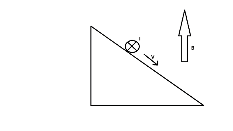

A wire with a current of I (flowing into the screen) moves down on a slope.
What is the direction of the magnetic force acting on it?
I have no Idea why the answer isn't horizontal, but rather opposing its velocity direction.

In your original diagram you had the field vertical, but now you show force as vertical and field acting in the direction of v. Have you mislabelled the second diagram?
Also, the question as stated makes no reference to a field in the text. That only appears in the diagram. Did you quote the whole text?

I apologize, this picture isn't the same.
The magnetic field is indeed vertical, as shown before. This is just another angle to look at it (This picture doesn't have anything to do with the problem, just the angle).

So what, exactly, is the answer given in the book?
It says the force is opposing the velocity.
That is a bit vague. It does not necessarily mean that it acts antiparallel to the velocity, merely that it is in a direction that resists the movement.

Okay, so if we use the right hand rule with the velocity downwards and to the right, and the magnetic field upwards, then the force moves with the current. So, it is parallel, but not opposite. This is confusing me as well now, I might as well wait for the OP to respond and then continue.

Not sure what you mean by that. There will be an induced current. It is unclear to me whether the current stated in the question is this induced current or additional to it, but whatever...
The force that results should be normal to the field and to the current, so horizontal.

Try googling Lenz's law.
That only tells you the direction of the induced current. The resulting force will still be horizontal.
