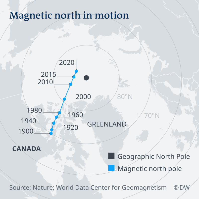

I am astounded to see how far the pole has migrated during my sentient life. I have spent a lot of time in the state of Maine over my nearly 70 yrs and the artic pole's migration has significantly diminished the incidence of spectacular aurora events ( even including the 11 yr sunspot cycle) . Pity.

What's true is that the magnetic field of the Earth gets weaker over the last decades and also the (magnetic) pole drifts quite fast. Some scientists think that this may indicate that the Earth's magnetic field may flip in the not too far future as it has done several times before.
http://www.esa.int/Applications/Observing_the_Earth/Swarm/Magnetic_north_and_the_elongating_blob
https://www.esa.int/Applications/Ob...rm_probes_weakening_of_Earth_s_magnetic_field

But movement of the pole is impressively away from Maine:
