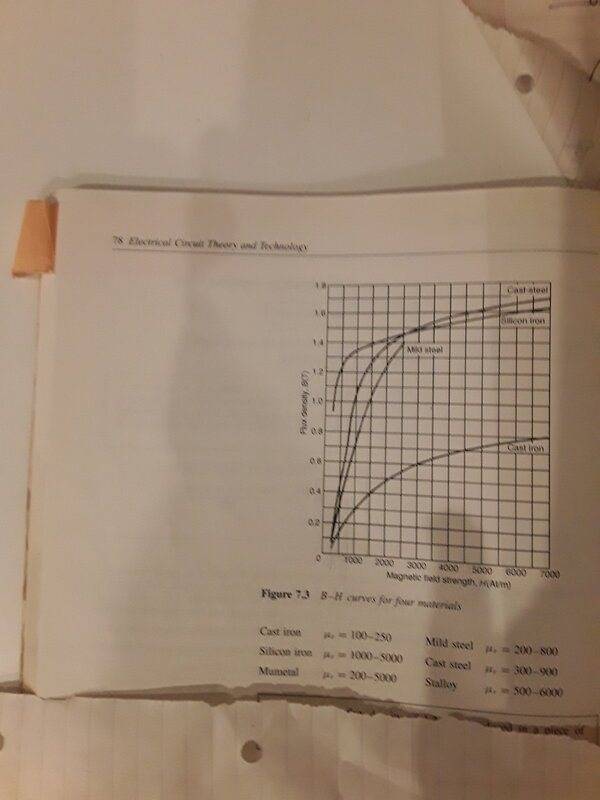

Summary:: This question is in relation to finding the mmf of a cast steel ring. Unfortunately I do not know how to post a picture of the page showing the graph.
[Mentor Note -- Thread moved from the technical forums so no Homework Template is shown]
A cast steel ring has a cross sectional area of 600mm2 and a radius of 25mm.Determine the necessary to establish a flux of 0.8mWb in the ring. Use the B-H curve for cast steel shown on page 78. (Ans 270A)
I don't know how to post a picture of the page showing the map here. Perhaps I might be able to find it online and I will try and link it here

[Mentor inserting blown-up image of the problem with better clarity]
Hello
These are the pages of both the question and the graph. I am also going to post my workings.
Cheers.

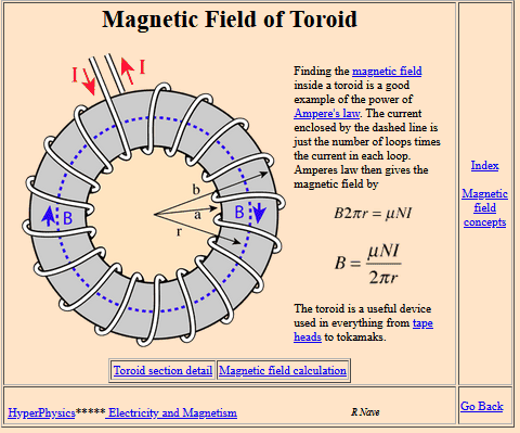

It's a bit hard to see your work (it's always best to type your work into the forum to make it clearer and to make it easier for others to quote). But did you use the centerline of the ring? It looks like that is the correct radius to use for such calculations:
http://hyperphysics.phy-astr.gsu.edu/hbase/magnetic/toroid.html
BTW, there are math symbols under the √ (square root) symbol above the Edit window, and there is a LaTeX tutorial link at the bottom of the Edit window. :smile:
Hi berkeman
Sorry about my awful handwriting. I will take your advice and use the symbols as shown. I'm just getting used to this forum. Thanks for sending me the link as I will explore it now. The image you sent of the toroid and your suggestion of using the inside part of the ring has shed some new light on this for me. Perhaps I needed the centre of the shaded area within the ring.
