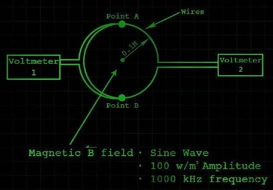

All I've been given concerning this problem is the diagram below and the instruction to solve for the total voltage at both voltmeters.
Unfortunately, I am not sure whether this configuration counts as a electromagnetic coil, or whether it is simply two single-wire circuits, one for each voltmeter, connected at Points A and B. It also isn't clear from the diagram whether voltmeter #1, and its associated circuit, is in the same plane as the other voltmeter.
The known data:
radius = .1m (A = .01pi)
magnetic flux density = 100w/m^2 or 100 Teslas
frequency = 1000 kHz
I have been assuming that this each circuit is a coil (with one turn) and that I can use Faraday's Law: EMF = dphi/dt
where phi = the magnetic flux = B*A*cos(theta)
Quite frankly, I'm stuck. I'm not sure what 'theta' represents. B*A = 100w/m^2*.01m^2*pi = pi webers, so flux = pi * cos(theta). Is theta the angle of the coil? And once I get phi, how to I use Faraday's Law?

I am not sure about the diagram, but since they say that the magnetic field is a sine wave, the magnetic field B must vary with time. Write B as a function of time.
